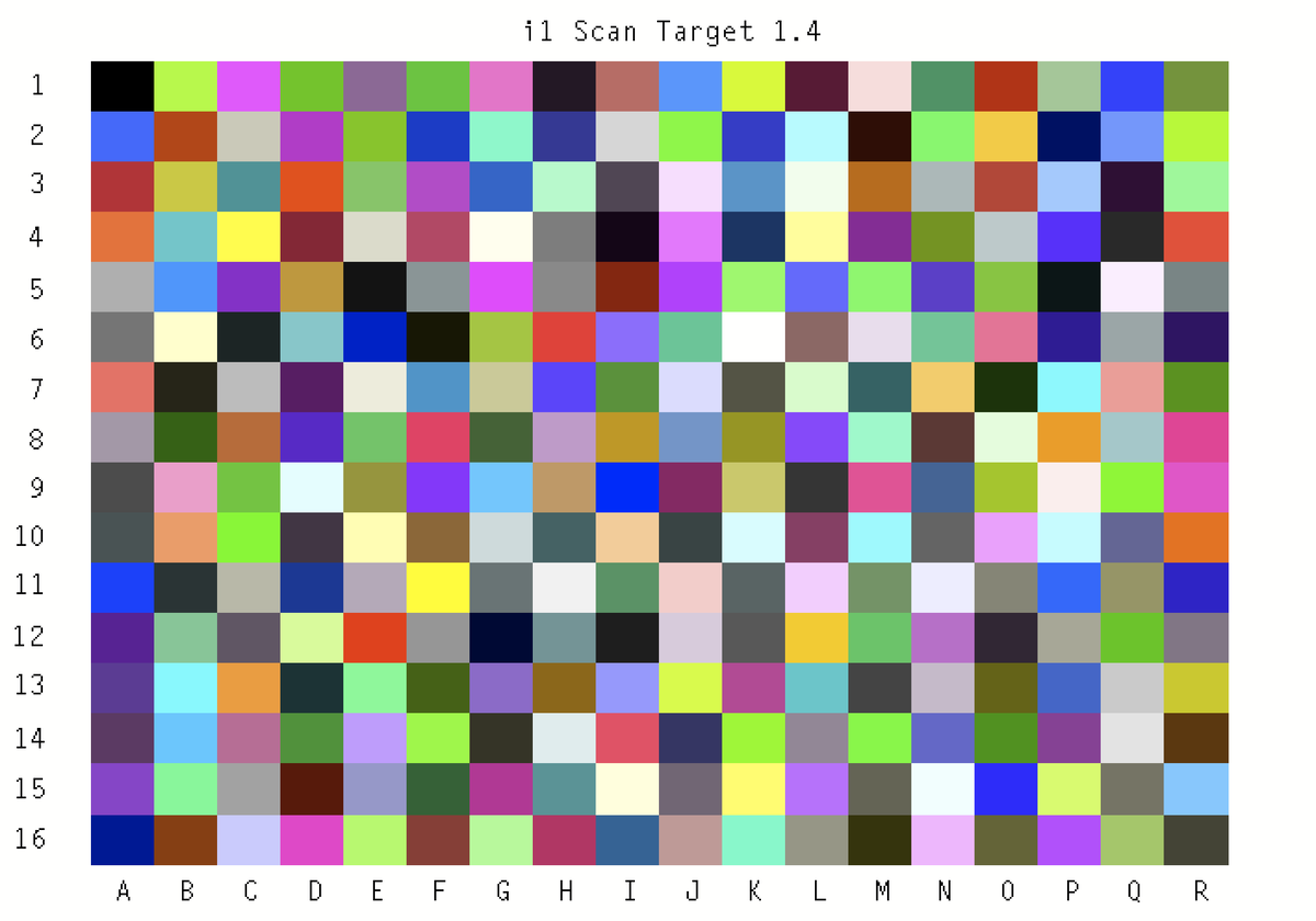

OK, here an example how good the scanner profile works on my Epson ET-8550 scanner.
Left: scanned without color management (in order to generate the scanner profile) and on the right the scan with the dedicated scanner profile (based on the scanned target (ti3 file) with my i1Pro2 in ChromIQ):
Much better than my old modus operandi using the Eye-One Match3 method with the vintage i1Pro1 that actually is based on the same principle. Scan the supplied scanner target with the i1Pro1 to determine the exact colors which are saved as a reference:
Afterwards: scan the target on your scanner without color management to obtain a tif-file and match the scanned image with the measured values of the same target to generate the final scanner profile.. This target has only 288 patches and 480 patches significantly improves color accuracy.
