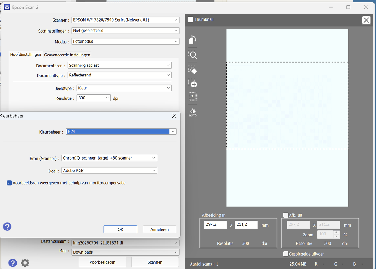

ahh ok, very strange place to look at
Anyhow, not sure what I am doing wrong, as the version I made with Eye-One Match (old i1Pro1) I got this:
Which is perfectly ok, but when loading the ChromIQ version I got nothing to see (something vague shadows):
I will test your latest version and try again.

If it goes wrong again please attach the files and maybe the logfile

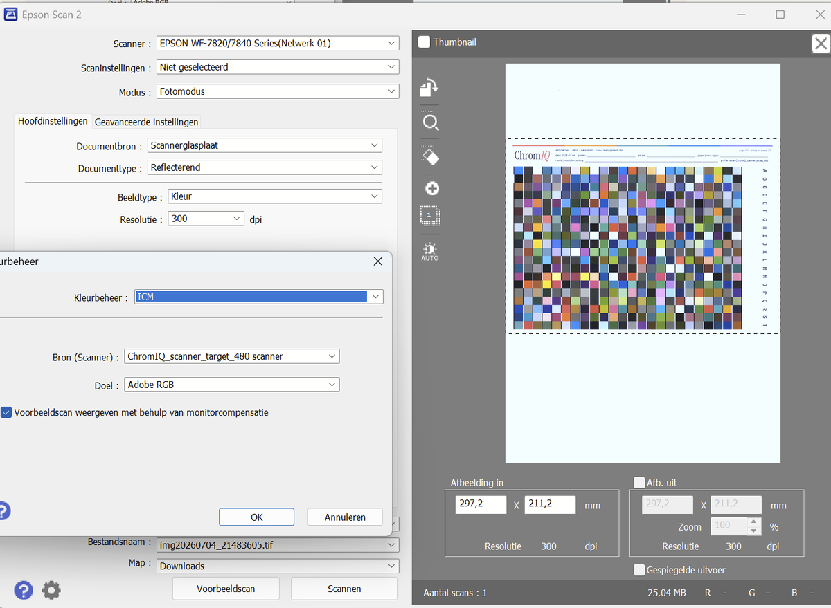

Yes it works now: I have turned the green mesh up-side-down and now it is perfect:

Nice! But it seems there was still some guessing involved and the program should have giving you a hint instead of letting you create a wrong profile…
Claude is currently still busy with Knuts request then maybe we can figure something out. Could you attach the files you used for this one so I have something to try it with myself?
