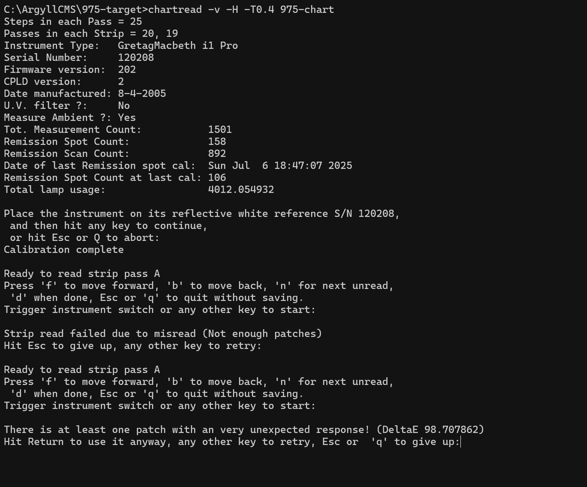

OK, I tried to scan the targets but unfortunately the same error happens:
I will try to read every row and save the file and see how the profile is generated.

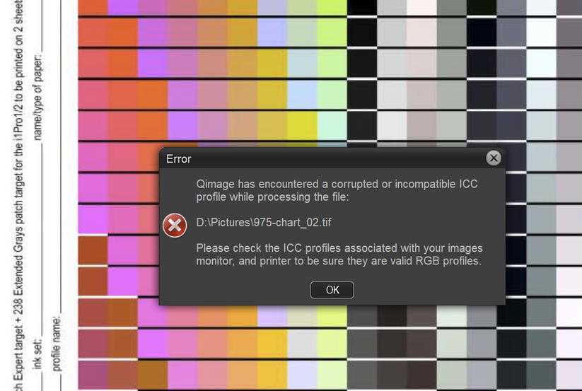

Also, you attached this image earlier, with an error from Qimage:
I assume this is coming from the image that you create from printtarg? Is printtarg embeding an icc profile on the image generated that is corrupted?
When I search for this error message: "Qimage has encountered a corrupted or incompatible ICC profile while processing the file:"
Google AI is instructing to try to strip or convert the color profile on the image to sRGB in photoshop or GIMP etc (save with or without profile).
Have you opened this image in photoshop or other software to see if the same error is there, or if the error is removed if you remove any profile or save the image with sRGB profile?
If you have that image it would be interesting to look at it. I do not get any similar error when opening images from printtarg that was generated using the ti1 files made by my script.
I would really appreciate your input to understand what is happening here.
Qimage had what I consider to be a bug or at best a useless error message. I don't know if it got fixed in the current version. If the Job Profile | Printer Profile drop down contains an icc profile Qimage attempts to read it even when OFF is selected in the drop down.
If that profile is missing you get this error message implying there is something wrong with the profile in the file you are printing.
