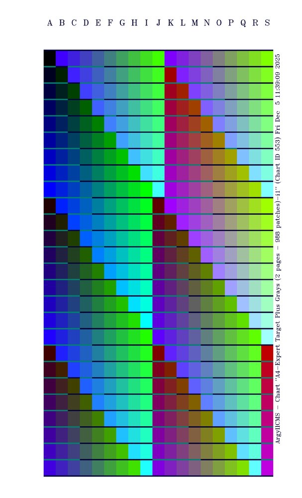

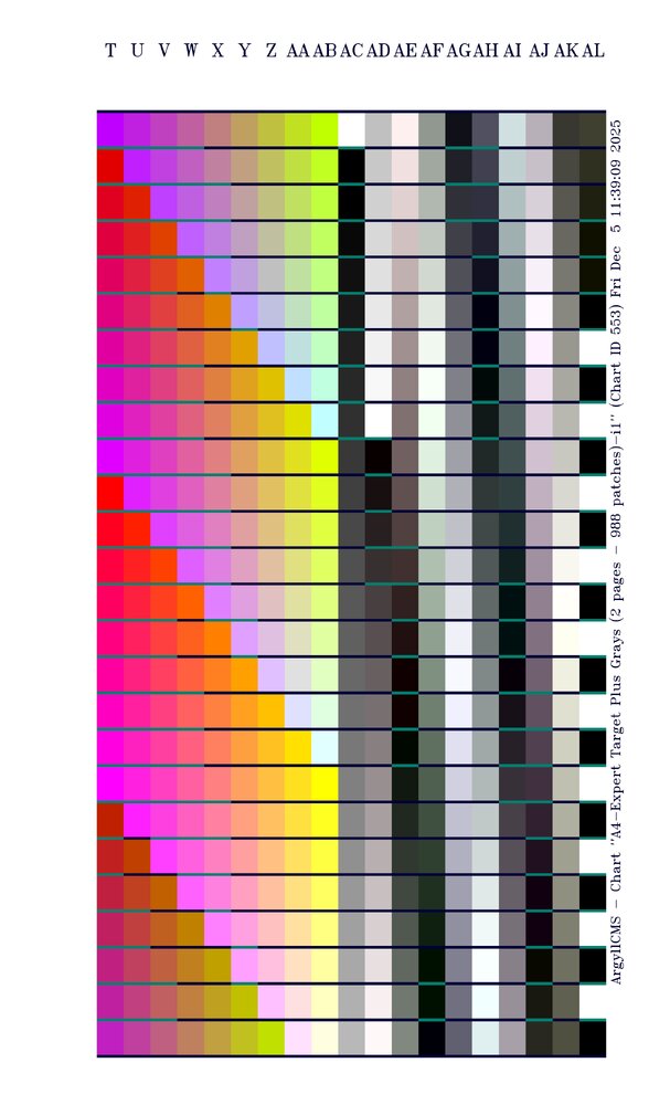

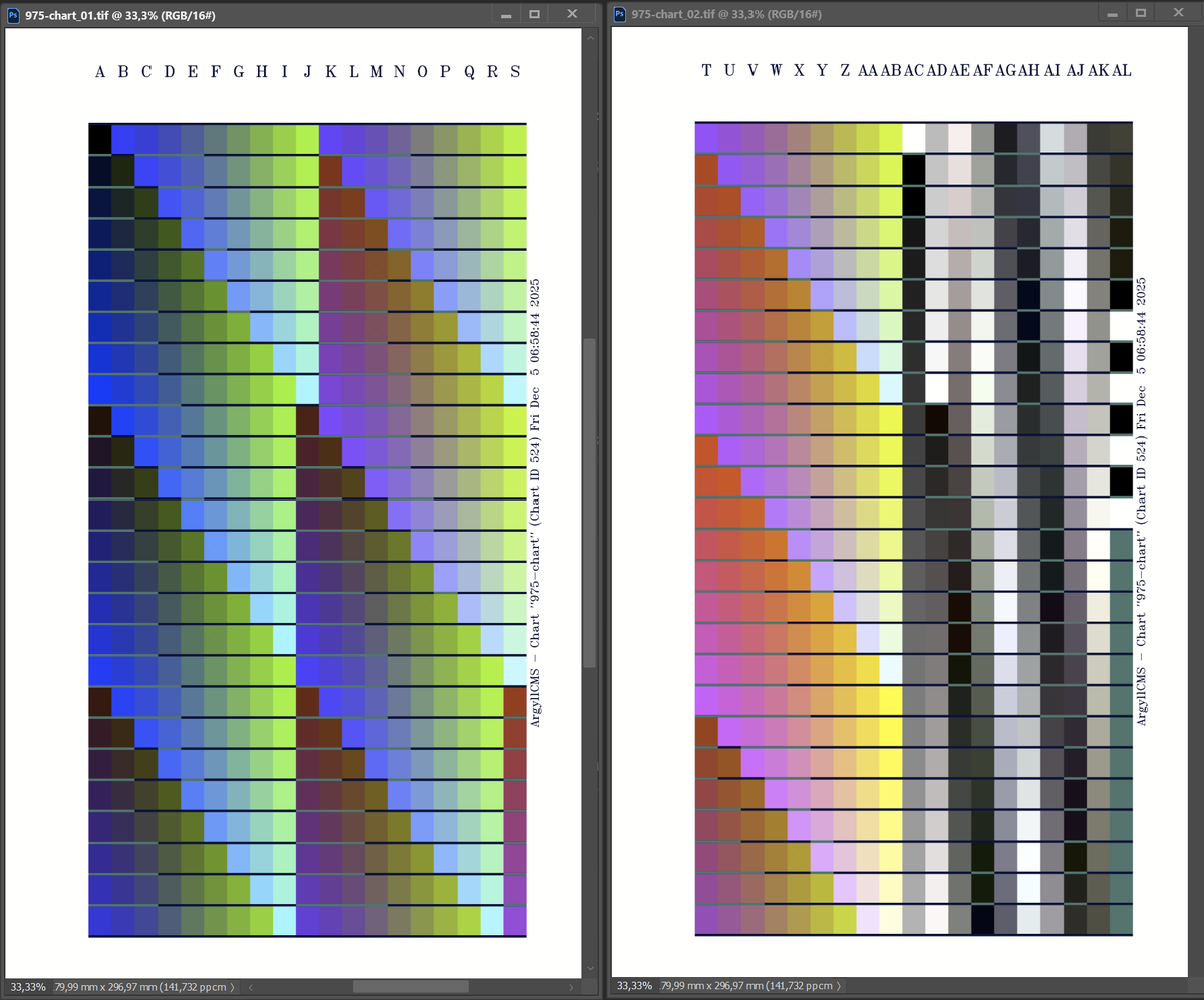

I am still trying to create a good divison of your new 975-target and I get this using the following command:
printtarg -v -ii1 -a0.9 -A0.85 -b -r -P -T360 -M10 -p180x297 975-chart
So I get a equally divided patch count per page and later I can use the stretch option to create a true A4 sheet (making the patches slightly thicker).
What I am concerned is the strange green empty patches on the second page (row on the right: bottom green patches). Normally I should get white patches when generating those empty patches. Not sure how this will interfere with the chartread command (will it be registered as empty patch or as real colour ?). Maybe I should PS to color those patches into true white. Another strange thing: the -b (black and white) argument should only give black and white space bars between patches and I see now greenish and black space bars....There is something very strange happening.

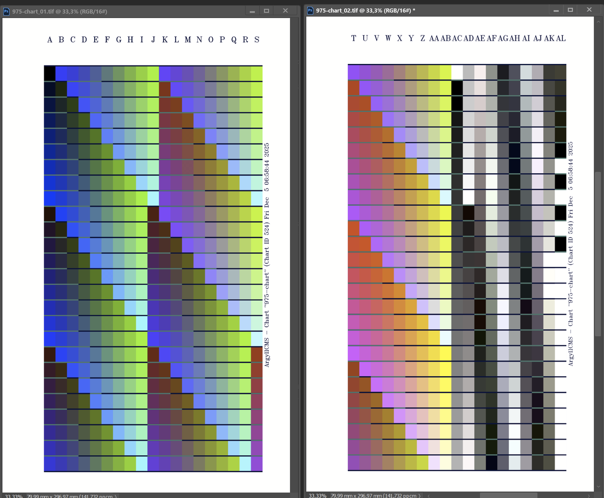

So it will become like this:

Thanks for showing how you create your target :)
This is obviously something with printtarg, which I also have seen. I would add patches for the last row to fill those green patches that are empty, but then the patch count will no longer be 975, if that was your aim to keep the same count. th original two charts have 967, so the the last 8 black and white I added to get perfect fit on two pages for the -iSS (SpectroScan) target type in my examples. Strange that it is so hard to get that perfect fit with the same number of patches for i1.
Did you try the latest chart example created with the script? I wondered if there would be any change using those ti1 files, with regards to the green spaces, as they now have these tags generated automatically:
WHITE_COLOR_PATCHES "13"
BLACK_COLOR_PATCHES "14"
COMP_GREY_STEPS "38"
SINGLE_DIM_STEPS "9"
I attach the two examples here, one for SS (1 page 975 patches) and one for i1 (2 pages 989 patches). I added those extra patches to fill the end row.
I tried your command with the latest attached generated ti1 file, but I had to modify to 988 patches to get a perfect fit on the page.
Bash:
printtarg -v -ii1 -b -r -P -a0.9 -A0.85 -T360 -M10 -p180x297 "A4-Expert Target Plus Grays (2 pages - 988 patches)-i1"
This was the result:
As you can see, there is still the green spacers.
I don't think I can make those go away, unless someone finds out why printtarg make those. Not sure the ti1 files I have generated are the cause.
