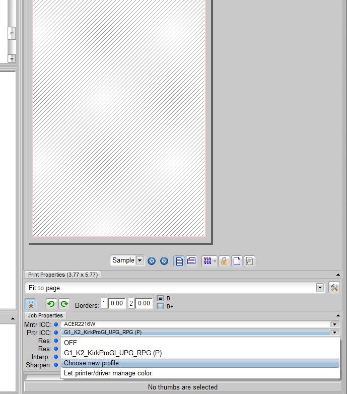

Now we are going to start to do some printing.
We have installed the profile and it is in the correct folder.
After installing Qimage the opening screen should look somewhat like this.
We are going to use the Prtr ICC dropdown near the right hand bottom to select the printer profile we have selected.
Pick Choose New Profile in the dropdown selection
