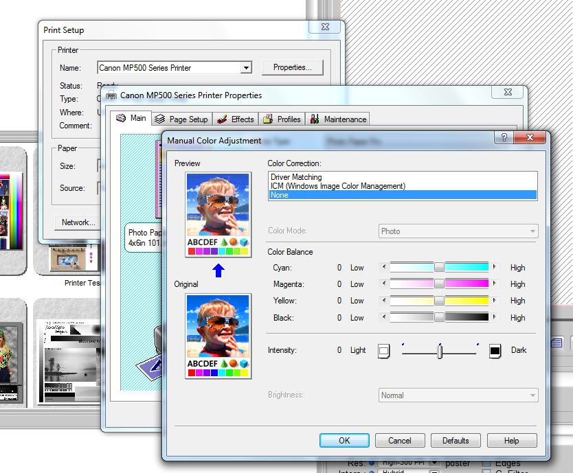

Again take note as many mistakes are made right in this part.
under COLOR CORRECTION Select None
make sure all the sliders are in the middle.

make sure you select OK for the settings to stick.
Qimage will remember these settings for this profile. These settings will not change the setting for the printer outside Qimage, Qimage has the ability to retain these settings every time you use this profile. You might want to double check to make sure.
