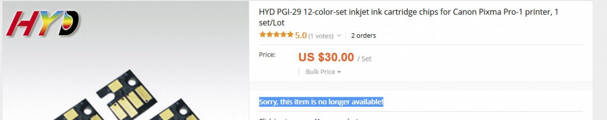

Have you guys seen the "New" style of Chinese PGI-29 compatibles?
http://www.alibaba.com/product-deta...60086526265.html?spm=a2700.7724838.0.0.HQQVQU
There doesn't seem to be a Light Pipe to conduct the red recognition light from the Chip to the Front of the cart!!!
And what's with those grooves on the tops.
Oh and the company I was getting chips from no longer carries them!!!!
What Happened?
Mike I hope you got a ton of them!

Sorry, this item is no longer available!
I’ll email them tomorrow to find out, but they were doing business back in June, so I suspect they are still are in business. :hu
