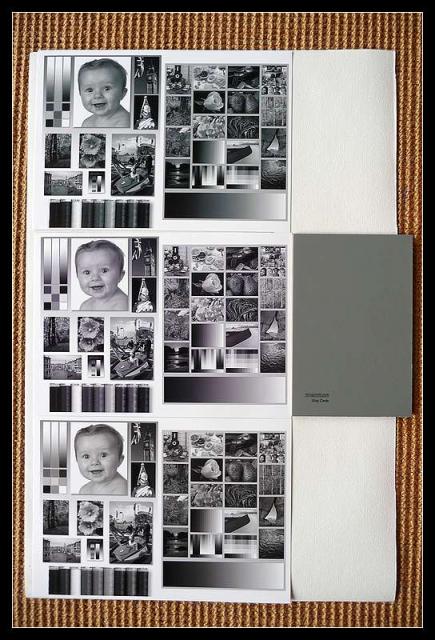

What about the neutrality of the ABW mode printing true black and white printing ? This mode will use the 3 blacks and includes Light Magenta, Light Cyan and yellow to counter the warm glow of the K3 inks. The interaction of K3 (3 blacks) and the lighter colours is very critical and also depends on the paper used to yield the most neutral B&W prints. This is the most important litmus test if an aftermarket ink manufacturer has done his job well.
Have a look at the picture below, shot with a gray card as reference to compare the neutrality of B&W print.
There are 3 prints, printed with the following inks on the same paper: Aldi's SihlX 280 gsm and the ABW-mode (setting: neutral, tone: dark) for picture 1 and picture 2. Picture 3 is done by first processing the image to gray scale and printing with the Inkjetfly IMA 24/36 inkset with dedicated profile with gray ramp correction (Colormunki 3 sheet profile).
1. Inkrepublic IRK4-nano (ABW-mode)
2. Inkjetfly IMA 24/36 (ABW-mode)
3. Inkjetfly IMA 24/36 (colour mode, image converted to gray scale, printed with dedicated profile with gray ramp correction)
As you can see: the Inkrepublic IRK4-nano has slight greenish cast on the prints (as stated by the Inkquisitor website, but not as heavily), the Inkjetfly IMA 24/36 definitely a purplish cast and the most neutral and the best to my eyes is the 3rd version printed in colour mode with a dedicated profile, albeit with a slight yellowish cast. When I used the Image Specialists IM-K4 inkset I also experienced the same purplish cast with the ABW-mode as with this Inkjetfly IMA 24/36 ink set. Is is this a problem: yes if you insist on neutral prints, but one can use the colour wheel in the ABW mode to counter the cast with the opposite teint. Please note: the ABW mode is optimized for Epson own proprietary papers and might not work well with other brands of photo paper, so using the colour wheel is obligatory to counter these types of colour casts.

Your findings regarding the IJF ink are similar to mine - excellent gamut and good gloss, albeit not quite up to OEM standard for gloss. I have found that setting the colour density to +20% for Harman Gloss Baryta (before profiling!) gives me the optimum gamut and Dmax. For Ilford Smooth Pearl and Harman Crystaljet Elite I find +10% is optimum.
Like you, I found that in ABW the "neutral" setting gives a magenta bias. I find that setting the colour wheel to -12 (Horiz) 15 (Vert) gives me very nice B&W on my favourite Harman Gloss Baryta. Beautifull prints with no discernable bronzing and negligible gloss differential. In ABW mode I also find that increasing the colour density gives optimum results.

For RogerB: Do you know for the Inkrepublic IRK4-nano inkset in the ABW-mode I have to slide the colour wheel exactly +12 horizontally to make the prints neutral. That is: the opposite of your H -12 setting for the IJF. I will try this later on. I can confirm your problem with the gloss: very good but not as good as the original Epson K3. The Inkrepublic IRK4-nano yielded a slightly better gloss compared to the original K3 ink. Gamut is slightly worse however. I discovered the strength of the Inkjetfly IMA 24/36 inkset is density of the two magenta's (M and LM). It could be that this causes the magenta cast in the ABW-mode and the smaller gamut of the magenta's of the IRK4-nano causes the slightly greenish cast in the ABW-mode. The ABW-mode uses the K3 (3 blacks) and the light magenta/light cyan and yellow produce neutral B&W prints. That is, when these colours are well balanced. A stronger or weaker magenta will give the end result a colour cast. Maybe we should mix the Inkjetfly IMA 24/36 LM and M with the Inkrepublic.com's IRK4-nano LM and M on a 50/50 basis to make the most optimal colour strength.
