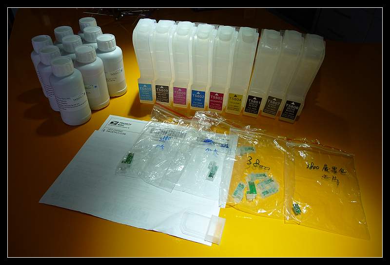

Recently Leo Chang (Inkjetfly.com) contacted me to test their latest refillable cartridge system (Big Foot) for the Epson Pro 3800/3880 printer, replacing their older bag based cartridges with resetter.
I had similar cartridges tested from efillink.com, who ask me about the test them, because they were finding out which cartridge system would be the best. Despite their similar design to the original OEM carts, the construction quality was suboptimal. The way these cartridges had to be refilled combined with the material (rubber) of the refill hole/ink outlet hole, makes me wonder how well these carts will last, since with my first carts I tested a few years ago with the same rubber ink outlet hole valve I had a disastrous leak from one of the cartridges, as the rubber material of the ink outlet valve ruptured and instead of pumping the ink into the CISS piping system of the printer, the ink flooded the inner side of the printer, making it a complete mess.
The repeated insertion and extraction to refill these bag based carts through a rubber inlet valve will put extra stress on this easily deteriorating material much heavily (rubber easily will rupture after time due to material fatigue and oxidation, similar to rubber elastics tearing apart and rupturing after a certain period).
Now back to these Big Foot Pro 3800/3880 refillable cartridges. There is also a smaller Small foot version of the cartridges, not requiring you to remove the cartridge cover and these will be reviewed by Irv Weiner (a member of the nifty-stuff.com and dpreview.com websites).
The system consists of the following items:
-9 very large cartridges (gun-shaped) with a easy to open refill hole (made of silicone presumably)
-7 dummy chips
-2 tuning chips with need the original PK and MB chips (you will need only these 2 ones)
-1 resettable maintenance chip replacement
-a plastic key to simulate closing of the ink cover
-Inkjetflys own proprietary IMA24/36 K3 pigment ink set.
-manual (rather basic though)
Above picture shows the package with the 2 tuning chips, 7 dummy chips working together with the 2 tuning chips and 1 resettable maintenance cartridge chip (waste ink tank).
The 2 tuning chips have 3 pins underneath them to make contact with the original OEM chip to be functional. This is a very good concept: maybe in the future the manufacturer could attach the OEM chips on 2 of those tuning chips, thus making it more interesting for those not having these OEM as they might have thrown away the old cartridges. The Inkrepublic Pro 3800/3880 I-refill system also has two tuning chips as well, but still needs the other 7 original OEM chips to function. The whole chipset will always stay full and it is by visual inspection you should refill the cartridges when time comes. I am not sure this is good idea for the maintenance tank. The Inkrepublic I-refill system maintenance tank chip can only reset back to empty (or 100 %) when the chips register as empty, even though you can reset cartridge chip back to full every time. I think this a safeguard forcing you to check the maintenance tank and replace the absorption material when it really gets full. Staying full all the time can be dangerous, when one do not check the maintenance tank on a regular base to prevent overflowing. Since both cartridge systems are transparent or semi-transparent you can visually check physical ink level at any time, so staying full electronically is not a big problem in this case.

Above: left the two PK and MB carts with tuning chip with OEM chips and right the seven other cartridges with only a dummy chip. A very clever system indeed and much easier for the end user, then having 7 or 9 original chips installed from the original carts, which might been already through away by the end user.
So all the cartridges have been filled by me and sealed.

The next day I tried to figure out where the problem lays and I discovered the PK cartridge tuning chip did not make contact with the PK OEM chip. There was a manufacturer error in the cradle of the tuning chip, that seems to fit not optimally on the OEM chip. I could feel the tuning chip cradle was jumping back away from the OEM chip. I had to put tape between the cradle and the cartridge to firmly seat the cradle onto the cartridge and thus the OEM chip. Quite annoying, but fortunately I figured out the exact problem of the error message on my printer.
