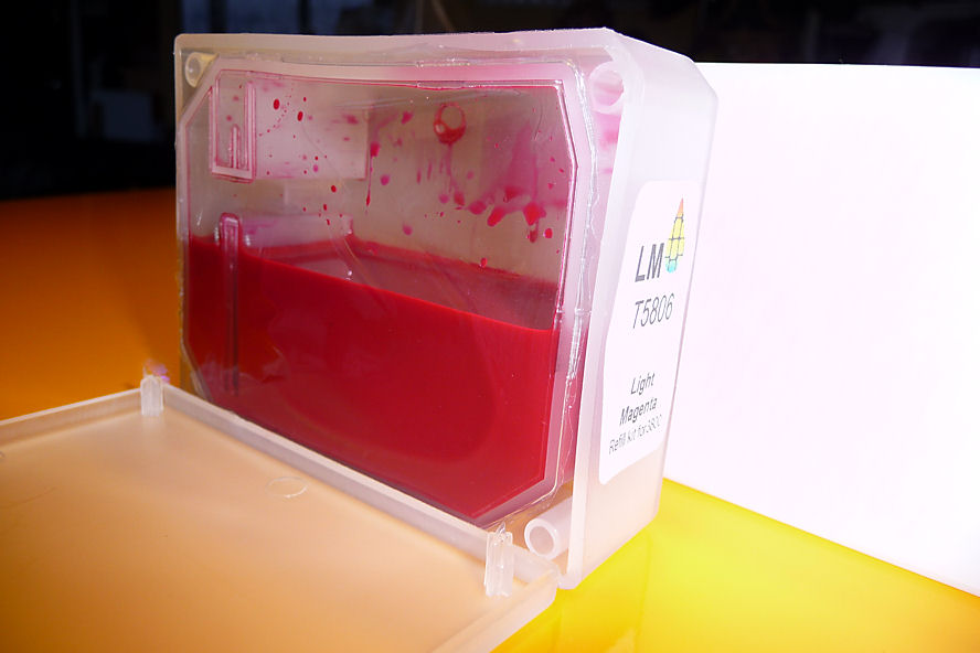

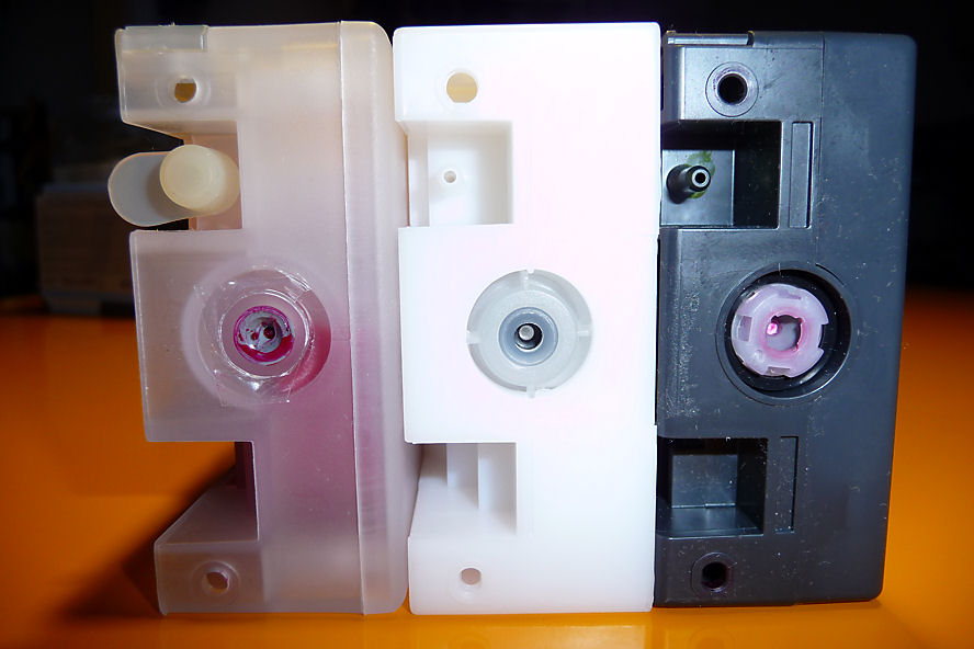

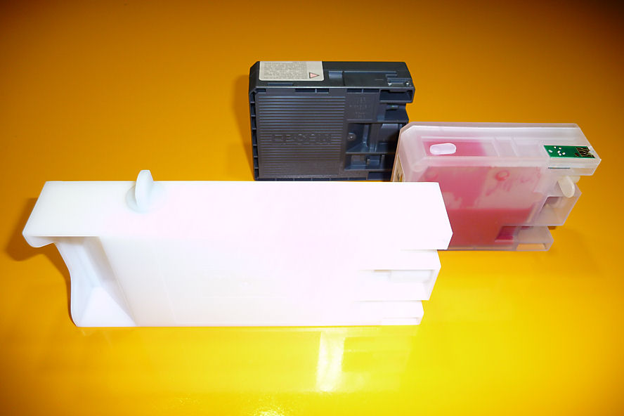

Take a look at the following cartridges. Although the present refillable cartridges installed in my Epson Pro 3800 are working well, albeit with some minor flow problems, I am a bit shocked how these cartridges were manufactured. The Epson Pro 3800 uses a pressurized system to push the ink into the tubing system of the internal CISS-system to provide a constant ink flow towards the print head.
The next picture is showing the 3 cartridges in a row: Colordroplets refillable, Inkrepublic refillable, Epson original. Take a careful look at the ink outlet port. The Inkrepublic.com is extremely well made and seems to be even beter than the original Epson cartridge. The left cartridge by Colordroplet uses a simple rubber seal, which does work well, but rubber tends to starve and crack on the long term and by inserting the cartridge repeatedly into the printer might damage the delicate but essential seal (risk of massive leaking, when the printer putting pressure in the cartridge !!!).

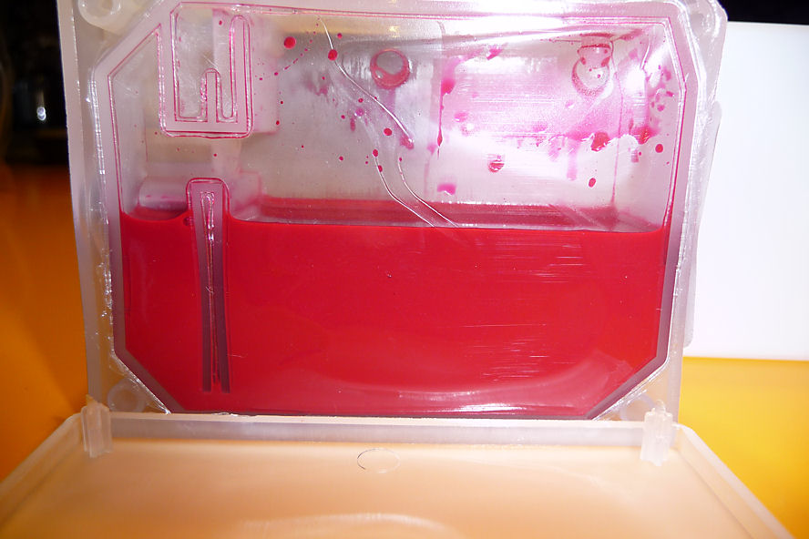

Hmm, discovered this today of the Colodroplet cartridge: the side panel can be removed and ....the ink is kept within the cartridge boundary only by a thin piece of plastic sheet. It seems to be very strong, because although the system is pressurized, the ink is still be kept inside the cartridge, but it scares me off how long this ink will be kept inside the cartridge and will not leak out with force from the cartridge.
A side image of the plastic foil sealing the the cartridge. Quite scary indeed...:
