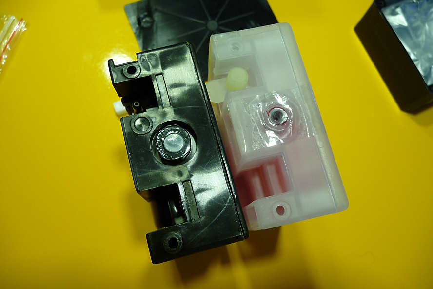

Two weeks ago I received the cartridges from Efillink.com (same as the ones from Inkjetfly.com and Ink2image.com). Due to my profession/occupation I did not have much time to experiment with the cartridges sofar. These cartridges feature a special bladder-based system like the original cartridges. The system should ensure a steady ink flow towards the printhead even when the cartridge is almost empty. The chip resetter included with the cartridges is exactly the same as the one I have with the refillable cartridges from colordroplets.com, albeit a bit lighter (using tiny batteries).
The next picture shows the tuning chip making contact with the printer circuit:
As you can see: the electronical part of both the efillink.com's and the colordroplet.com's refill system is made by the same manufacturer and should be exchangeable:
The ink outlet valve differs a bit from the colordroplet.com's system and is also the refill hole for the cartridge:
I figured out how to refill the cartridges, but I do not think it was a success :rolleyes::
The bladder was accidentally pierced by the sharp needle and more than likely rendered unusable by this action.
I tried to inject distilled water into the cartridge to see what happened:
The water is oozing from the hole and escaped into the pressure chamber of the cartridge :(:(:(:
Since the cartridge is already damaged beyond repair I cut the bladder to reveal the design of this particular cartridge and, unlike the original OEM cartridge, only one side is using a bladder material. The OEM cartridge is using a real inkbag which sits freely into the pressure chamber:
So this experiment is unfortunately a failure and I ordered some thicker and shorter needles to us to refill the cartridges and I hope to report back soon about the results. I am a bit dissapointed by the poor building quality of the cartridges and I hope they will last for a long time, because the comment on ink2image.com says: "...The Ink2image cartridges can be refilled many times but will eventually show signs of wear at the ink exit port seal. Replacement cartridges are available at the low cost of $ 20.00 each when this occurs.....".
I had once a bad cartridge from colordroplets.com and the rubber seal was ruptured causing the pressurized cartridge to continously ooze ink into the system and flooded the paper tray and my table the printer was sitting on. Cartridge empty and a complete mess with Light Magenta ink to be thoroughly cleaned by me :rolleyes:. The key part for a succesfull refillable system for the Epson Pro 3800 is to ensure a tight seal around the ink outlet valve, not only directly after installation, but also after months of intensive usage. Rubber unfornately suffers from cracking and rupturing (material fatique) quite soon and when this happens to a pressurized system, like the Epson Pro 3800, inky disasters are very eminent !!!
I also tried to reset the tuning chip with my older resetter for my previous colordroplets.com's refillable system and it worked flawlessly, so the system is the same. So for the electronical part I am pretty sure these cartridges will work flawlessly, even though I did not have the chance to refill them and install them into my printer.
