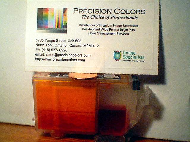

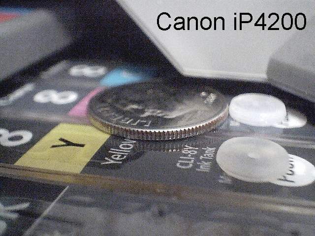

The thickness of the protruding flange on the Precision Colors silicone rubber plug is about the thickness of a U. S. penny. Both of your printers, Canon MP600 and iP4300, are capable of printing on CDs which requires the print head to raise a little while printing. I have a model iP4200 which is very similar to your models. It has Precision Colors plugs in the cartridge refill holes and prints CDs well with no clearance problems.

Thanks Emerald. Nice Photos. I believe your 4200 has a little more clearance than my IP4300 or MP600. Will keep my fingers crossed. How did you stop the print head carriage from moving to take a photo? Thanks for your efforts. Regards

I will give you a dollar for every 100 of your "pennies" in the second picture. :D

That's today's Roosevelt penny, worth about the same as a Lincoln penny of my youth. :D
ruffin:
Re: "How did you stop the print head carriage from moving to take a photo?"
I didn't. After opening the lid, I pulled the power cord and slid the print head carriage under the extruded
plastic section of the printer top by hand and snapped a picture with a web cam.

I've just measured my ip4300 and I estimate the clearance = 3.5mm. So the maximum allowable protrusion above the cartridge would be about 3mm.
This is plenty for a panhead plug - provided the plug is pushed down as far as it will go into the cartridge. This was a useful check for me because one of my plugs hadn't been pushed all the way - there was hardly any visible clearance for this cartridge, but it wasn't catching so it must have been just enough.

Emerald: Thats terriffic. You helped me out greatly! I will follow your lead and pull the plug on mine as well and lay a penny on top to verify clearance. Thank you so much for helping me. Really didnt know how I was going to accomplish that task. I assume that pulling the plug wont upset the memory program that allows direct print to cd and English language, etc. You guys really know your stuff. I do appreciate your efforts and thank you again. Best Regards to you and the other guys and may you all have a very nice Christmas. Thanks for all your comments. Just a great group on Nifty.

Ian: Appreciate your measurement on the IP4300. I will be sure to press the silicone plug full home to ensure clearance. Thank you for the assist. Best Regards
