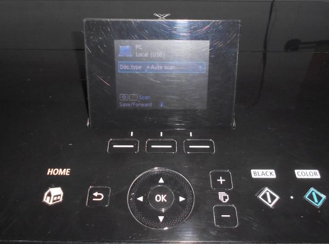

This is how it looks like on a MG5350:
<--- click to enlarge
You can select how the file is saved from the "Save/Forward" menu - Atach to email via PC, Forward to PC and you select how, Save to USB flashdrive or Save to memory card.
If "Forward to PC" is selected it will save the scan to C:\Users\YourUserName\Pictures\MP Navigator EX\Date
How is your printer connected to the computer?
P.S. The software is called MP Navigator EX and you can find it here: http://www.canon.ie/Support/Consume...x?DLtcmuri=tcm:24-858192&page=2&type=download

Thanks for taking the effort with the picture. Your printer controls layout and LCD screen look almost exactly the same as mine.
"Forward scanned data to a PC" is selected.
