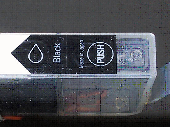

With the knife, carefully score the label just below the text indicating the color.
Carefully peel back the label to expose the nylon ball sealing the tank.

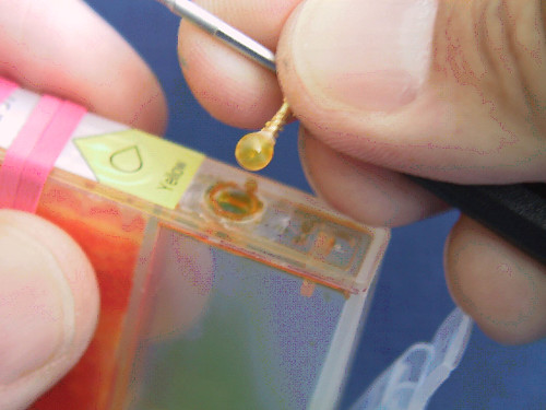

With the safety pin and pliers, start a pilot hole for the screw eye in the center of the nylon ball.
Only push the pin in about 2-3mm.
Insert the screw eye and turn until tight. 2-3 full turns should be enough.
(You want the tip of the screw just past the halfway mark)
Putting a screw eye into the center of the nylon ball will actually expand the ball to the
point where you probably wont be able to drive the screw eye all the through the ball.
This is a good thing, as it will help create a nice tight seal when replaced.
(Also, you don't want a reaction between the ink and the metal of the screw)
Using a nail or the pliers, remove the nylon ball.

For topping off the tanks in the printer, I just grab the screw...
and lever it out...
