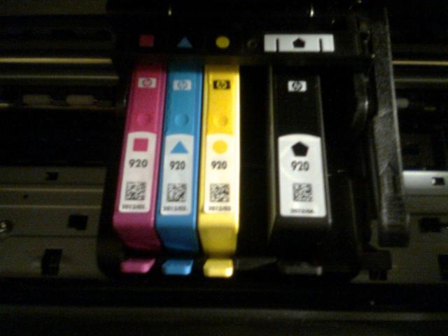

Metallo said:
This evening I will check, but I am pretty sure they are the 920.
I attach a picture I took yesterday evening, quality is bad due to lack of light with a basic cell phone, but it is enough to see the 920 carts.
Alex

Sorry, Tudor is right. WIth the 920 you fill ONLY the sponge chamber, and it does not hold as much ink. If you want to fill the 920, you can make an adapter like this:
http://www.nifty-stuff.com/forum/viewtopic.php?id=6750
or this: http://www.nifty-stuff.com/forum/viewtopic.php?pid=48731#p48731 , or you can buy a kit from InkTec, which comes with this:
http://www.nifty-stuff.com/forum/viewtopic.php?pid=46148#p46148 . If you fill the 920 cartridge, you should buy a 100-g scale and weigh the cartridge to find out how much ink to add. This works best if you weigh the cartridge when it's new, but if you didn't do that, you can muddle through until you find the right weight.
But to fill the 920XL, one method you can use is to fill through a hole you make in the top, as you described. But I think you have misunderstood one instruction. You wrote, "Fill 1/4 through the vent and then seal it." NO! There are three holes: the outlet, the hole you made, and the vent. With this method you only fill through the hole you made. You do NOT fill through the vent, and if you do get ink there somehow, you must clean it out.
