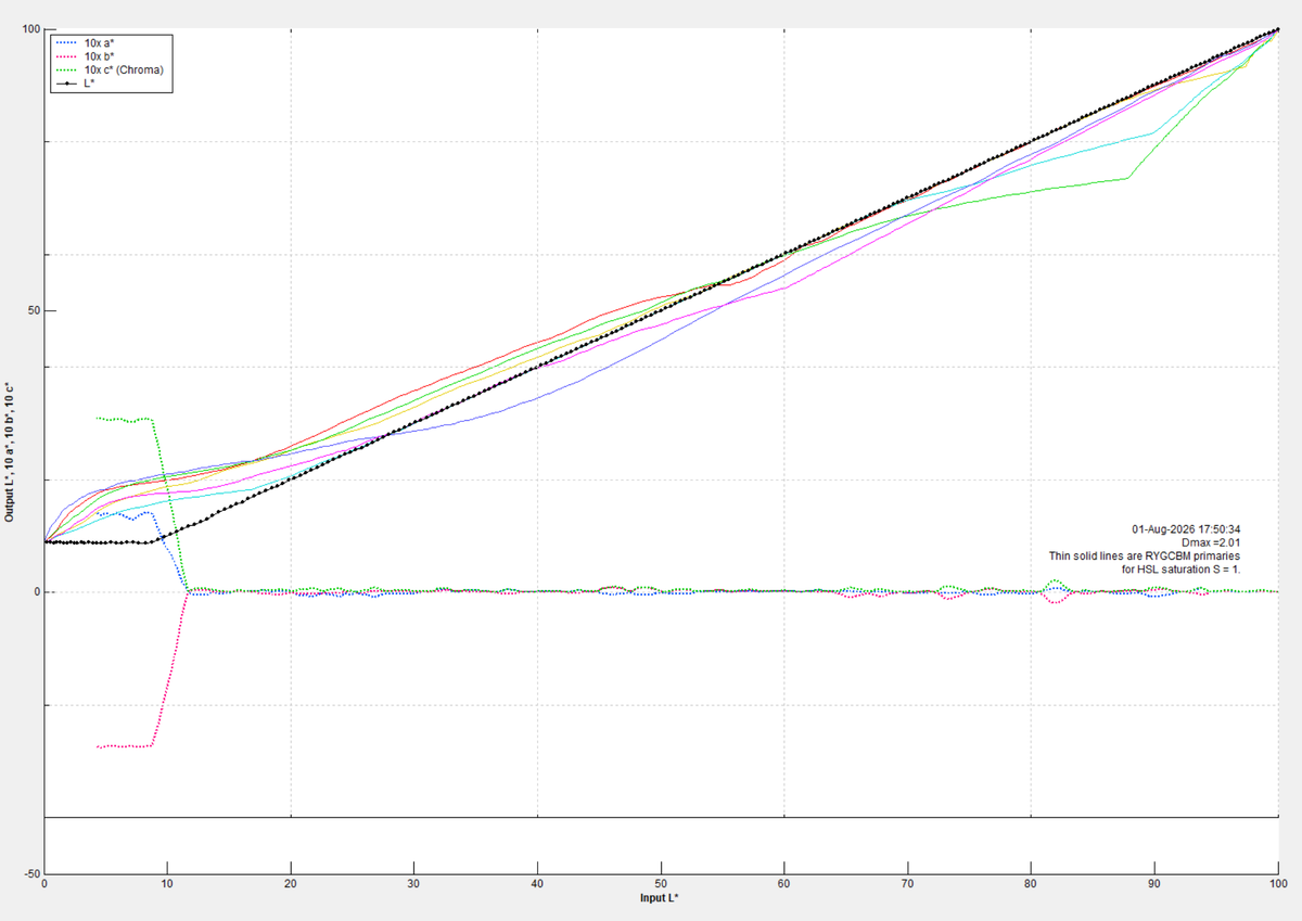

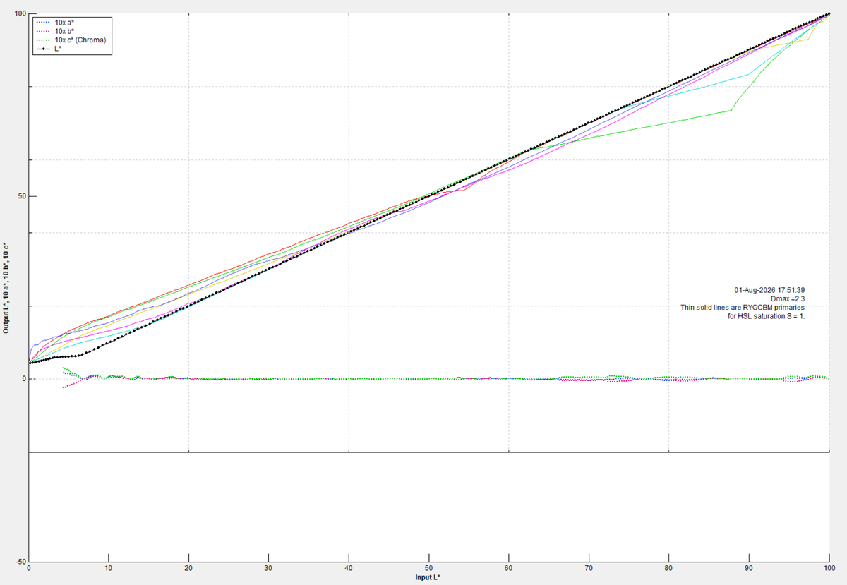

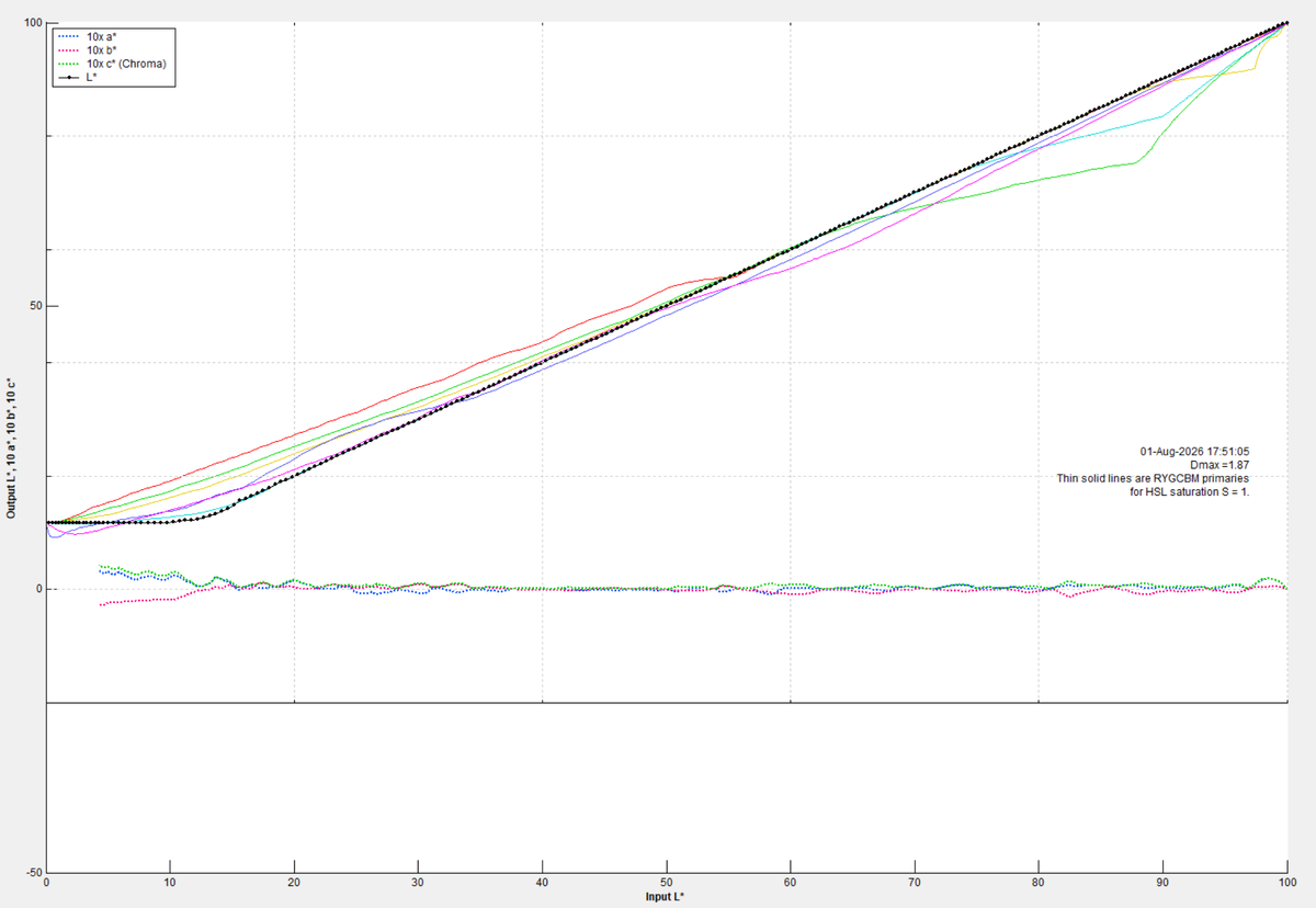

Sorry it took me so long to get back to you. My goal was to see whether it is worth it to pay quite a bit more for the Epson ET18100, or to go with the cheaper IP8700 + GI-53 refills. The plots below show the greyscale linearity and dmax of both combinations for the colorimetric rendering intent. Bonus: Epson R3000, my good old workhorse with custom-made pigment inks.
ET18100
IP8700
R3000
Both dye printers have a rather weak black point, but the difference between the Epson ET18100 and Canon IP8700 is small enough to make me go with the cheaper one. Greyscale neutrality is surprisingly decent on both. I'll report back when I receive my new toy and find some time to profile a few papers.

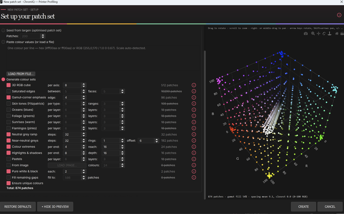

Not sure you have already taken notice of the new graphical user interface for ArgyllCMS that Sebastian and Knut are working on: ChromIQ (with help of Alan Goldhammer and me). It is a fantastic graphical shell on top of ArgyllCMS with a few new features especially the new patch generator that is far superior to i1Profiler and even ArgyllCMS patch generator. It can make targets for both ArgyllCMS (ChromIQ) but also for i1Profiler with optimized patch selection to sample the very important neutral/near neutral axis (important for neutral greys with good separation) which is not possible with the built-in "smart" patch generator by i1Profiler.
Above a simple example to generate a 874 patch target that emphasize the neutral axis to correct for the serpentine behaviour of some printer/ink/paper combination in printing greys.
Have a look at it and is free software.

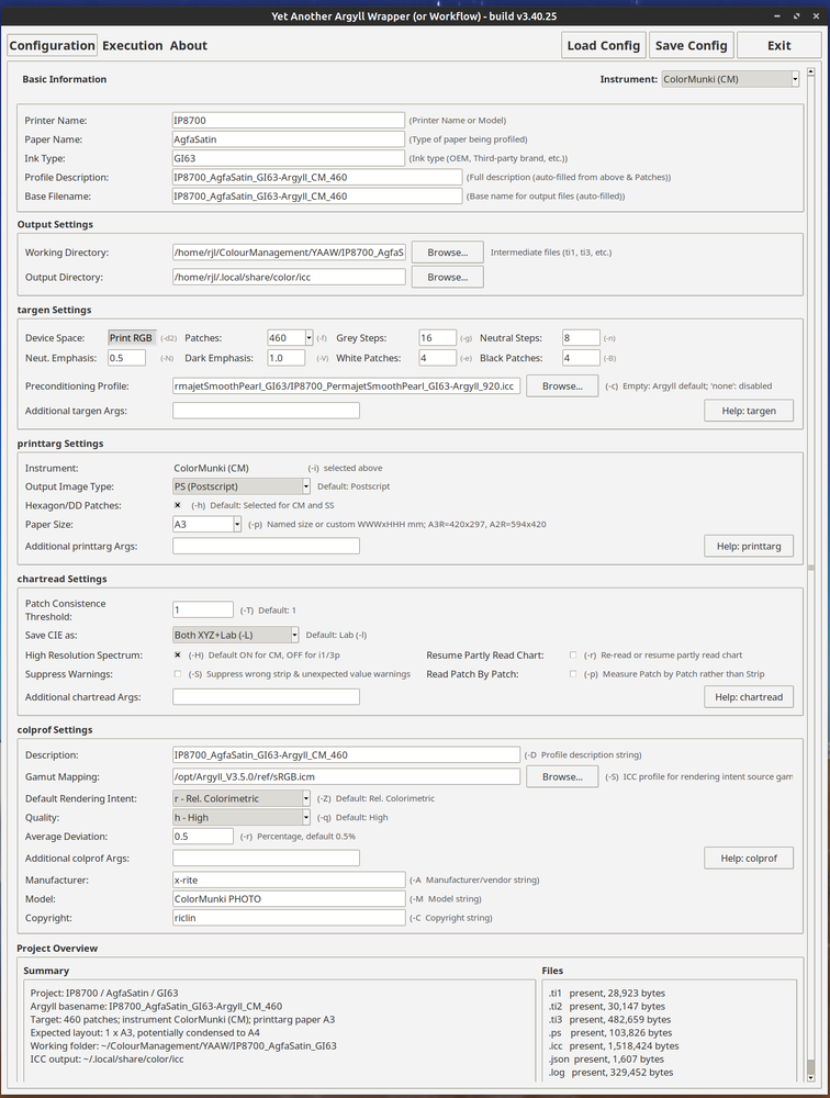

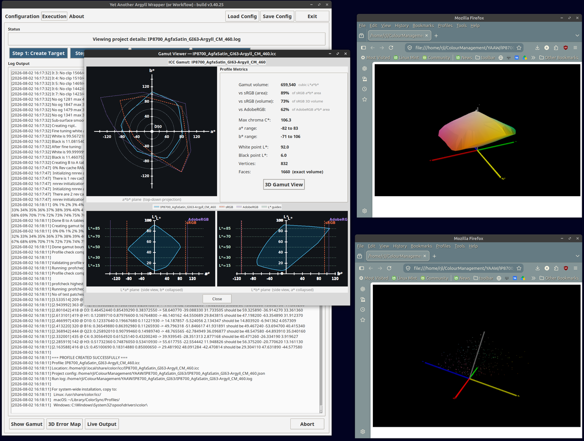

I’d also like to self-promote my somewhat less glamorous but fully featured approach to the profiling process: YAAW — Yet Another Argyll Wrapper (or Workflow). YAAW is a KISS application written entirely in Python 3 and tkinter, and tested under both Linux and macOS. It provides a robust front end to ArgyllCMS with (in no particular order): transparent operation; automatic field, filename and folder population; persistent logfiles; separate working directories for each printer/paper/ink combination; saved JSON configuration files for each profile; crash recovery; split-stage processing allowing multiple targets to be printed and later measured once dried; profile validation; support for preconditioning and gamut-mapping profiles; multipage and condensed-target workflows; static and X3DOM gamut plots; and integrated ArgyllCMS documentation.
It is deliberately simple and performs no colour management in its own right. Instead, it provides a logical, auditable, consistent and reproducible interface to the ArgyllCMS command-line tools.
Available for free download at github:
https://github.com/riclin-au/YAAW-Yet-Another-ArgyllCMS-Wrapper-Workflow
The github README file provides all the news that's fit to print ;)
