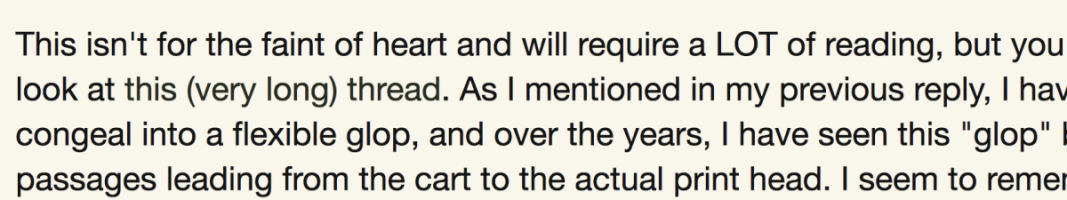

If you look closely at the text in the quote from Grandad35 you will notice that the text "this very long thread" is not black but a dark grey, and if you move the mouse cursor over it, it gets underlined. This indicates that the text is a link, clicking it opens the thread by Grandad35.
Here is the link again, but this time I changed the text colour to blue to indicate it is a link.
And here is the link not inserted in a text: https://www.printerknowledge.com/threads/clogged-canon-print-head.227/
@Nifty Could the forum software settings be changed so links show in a blue colour instead of a dark grey? I don't know if that is a standard but the blue text for links is often used on the web.

Thank you for clarifying that there is a link. I'm posting a snapshot for admin, where I'm sitting "this very long thread" is black rather than grey. Now to delve into reading about this, then I will surely have more questions. With much appreciation.

I must admit you are right, your screenshot shows no text colour difference in the link and the other text.
I'm using Windows 10 64 bit and Firefox is my default browser. I have also got Opera, Google Chrome and Edge that is a part of Windows, so I tried the other browsers too.
Firefox and Opera show the link text as dark grey, Chrome and Edge show the links in black like the rest of the text. I guess Apple's Safari or what you are using behaves in this way too.
I wonder if this is caused by the forum software or if some browsers are not fully compliant with webpage programming.

@Nifty If the colour of link text cannot be changed and maybe not will show in all browsers, then could the link text be underlined? IIRC links were underlined in an earlier version of the forum software. It's a pity that links are invisible to users of some browsers.
