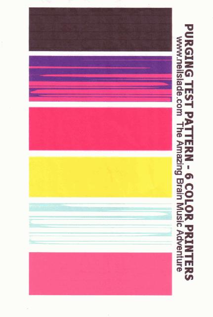

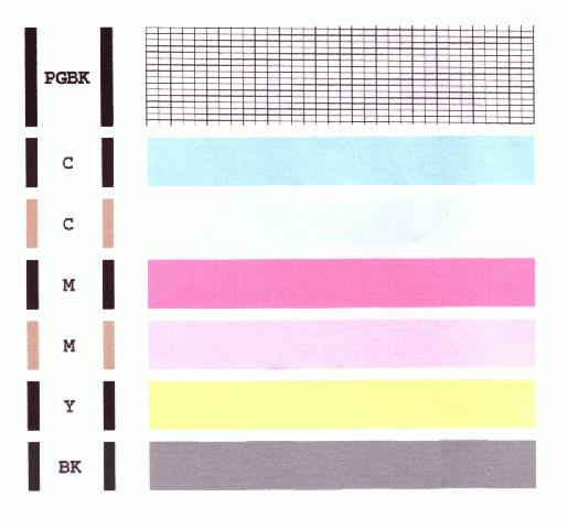

UPDATE:
1. Problem is worsening - Before i can print a whole cyan page and the problem only shows at the last part of the page. Now the problems starts right away.
2. This is what the Nozzle Check looks like after a good cleaning cycle.
(NOTE:Both light CYAN and light MAGENTAs 2 "vertical bars" should be gray and not brownish in color. Correct?)
3. Purging

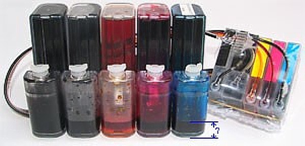

I have looked carefully at the supplier's website and at the photos of the ink tanks. I cannot tell exactly where the ink tubes connect to the external tanks. Does it look like the tubes enter the lower tank sections that are in front of the tall tanks? I think they do. If you can see just where they enter, please tell me or take a photo.
What is the elevation of the ink in the lower tanks in front of the tall tanks? I mean the distance from the table top to the top of the ink in those lower tanks.
the tubes connects at the bottom right below the taller tank. the short and tall portion of the tanks are connected. ink is poured on the shorter tank and will be tilted to transfer to the taller tank. the shorter tank also serves as the air vent/filter.
i don't understand. sorry
i'll try to find a working digicam coz both my canon cameras are dead (law of use and DISUSE).

Some have said that if you have OEM cartridges to put in the printer, doing that will restore the ink monitor and may make the printer appear to be in proper condition for warrantee work. This may not be true. I don't really know.
When I asked, "What is the elevation of the ink in the lower tanks in front of the tall tanks? I mean the distance from the table top to the top of the ink in those lower tanks." I was talking about just how high the ink is in the shorter, front tanks. In other words, if you put a ruler standing on the table and held it near one of the short tanks, how high would the ink in the tank appear to reach. Like 1/2 inch or 1 inch or just how high? Click on the picture.
I am assuming that the ink in all the short tanks would be at very near the same height above the table, unless some were over-filled. If the cyan is higher than others, tell me so.

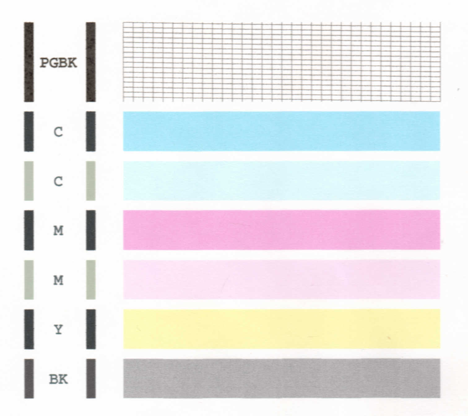

narmenia,
If this is useful, here is what my nozzle check looks like on my ip4300 today:

Your Cyan appears to have a clog in the print head. I suspect that your CISS at one time was not feeding sufficient amount of ink to the print head. It eventually developed a clog. Starving from ink is a known cause of print head clogging. You may be able to unclog it but it is very likely the print head is alreay toast. You may need a new print head soon even you can unclog it now. The problem of CISS for Canon is that ink feeding problems can result in print head damage. No matter how robust a CISS is there is always a potential threat there. Unfortunately most CISS made in China are produced in large volume and lack quality control. Most of them are not robust enough to be worth taking the risk in using them.

Websnail,
Look at my reply, #6 12/01/2007 3:59:03 pm with the picture of the unique ink tanks. Narminea has not answered my question about the ink height in the short bottle, but I think I know how the system is supposed to be working, and I think (don't really know) that the effective ink level is that seen in the short bottles. Scaled from the photo, the ink level looks to be only 1 inch above the table. IF my assumptions are true, the ink is not too high, rather it could be too low and forcing air-leak-at-the-seal problems. Narminea did say his CIS came with soft silicone seals to add to the original seals.
Of course all my assumptions about how this CIS operates could be totally wrong. I just hope Narmenia tries my elevation suggestion and your elevation suggestion. I am troubled by his report that an OEM cyan cartridge did not bring the printer back to proper function. Perhaps that means the suggestions of bad print head are really true.
