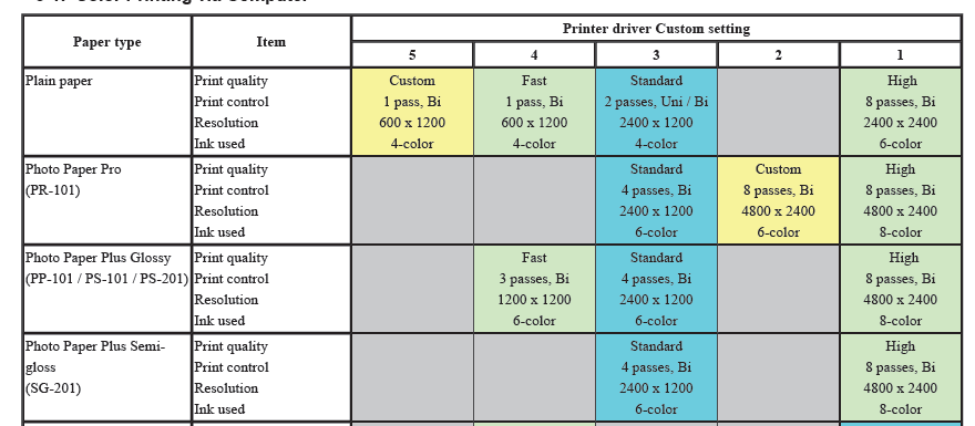

@Artur5, Your red and green carts will only get used if you continually print on high gloss using the maximum print setting, otherwise they stay dormant and only get used in cleaning cycles...
9000.PNG click to enlarge.
