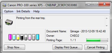

Ok guys, I think I can put this ink monitoring problem to rest, at least on my Non DIMed PRO-100.
I am just about finished printing another bunch of 13 x 19 prints and all seems to be behaving normal. Ink levels are being displayed as intended.

Thanks Joe for confirming that.
Now we know not to DIM the chips if you want perfect ink monitoring going forwards..:clap

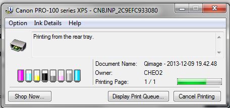

View attachment 326 Joe
Thanks for info Joe, and it is good to know.
My first regular (not DIM) reset cartridge is still too full to judge, but at least your tests give me reason to hope all will be normal.
Roy

So my routine now will be to wait till one cart hits to yellow "!" and at that point I reset all the carts and top them all off. Until I can get a second set of either new carts or empties from someone who does not refill ( There are a few folks out there ) I will have to reset and refill quickly as the PRO-100 will not sit there with the carriage in the ink change position for to many minutes. Using Squeeze Bottles / Needles does help to expedite the process.
