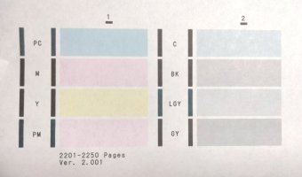

To preface, I am using a my pro-100 for art prints mostly.
Using precision colors ink refills on OEM carts- printing on Epson photo matte.
I noticed my black and white photos were printing with a blue-ish hue. I assumed that I may have dripped some cyan into my LGY while rotating carts. I cleaned all of the cyan out of the tray and printed once more- nope, still printing with a blue tint. I checked again and swabbed with a qtip to see if there was cyan ink- and yes, there was. it looked brand new! I realized that somehow my cyan ink was being siphoned into my LGY.
I cleaned the printhead very lightly- I just soaked it in 4/1 windex and rubbing alcohol. After running a cleaning cycle my prints were back to normal.
That is until I had to change my low carts. Printed, and... again... blue tint... same cyan residue in the LGY. I figured I must not have cleared the clog all the way and cleaned it once again.
However, it did NOT fix anything! My LGY is still getting contaminated and sucking ink from cyan.
So, what is actually happening? is it a clog? how on earth do I fix it at this point?
Attached nozzle check.

No its not a clog !..
Try cleaning the purge unit, by giving it a complete shower in Windex cleaner, splash the whole area and mop up the excess liquid with paper towels, then flood both purge pads with Windex and run a cleaning cycle, they try another nozzle check for the results..
P.S. Also Purge and then refill your L Grey cart to be sure…

If you refill your cartridges then overfilling can cause leaking. The leaked ink will pool on the purge pads and might be wicked up in the other nozzles. causing cross contamination. So if you are refilling make sure that your cartridges don't drip after refill.
Another cause of cross contamination is an internal leak in the printhead. This is caused by breakdown of a rubber gasket or epoxy bonds. This failure mode is often seen in older Canon printers. I think it is related to both age of the printhead and number of printed images. Here is an example of this failure. Another failure often seen in old Canon printers is electronic printhead failure. This can happen suddenly without warning. Here is an example.
If you have a set of new cartridges or a refill ink set you can check which cartridge is the culprit. Here is an example showing that cyan is contaminated with magenta. Notice the dull cyan and that the light vertical bars around the lettering have a magenta cast. I touched Q-tips to the outlets of the contaminated cyan cartridge and a "clean" cyan cartridge. Notice the difference in colour between the contaminated ink 1 and the clean ink 2, click to enlarge.
If cleaning the purge unit doesn't help then the only cure is a new printhead. Luckily the QY6-0084 printhead is still available as it is also used in the newer Pro-200 model.
As the Pro-100 is much more refill friendly than the successor Pro-200 I recommend to get a new printhead if needed. Only buy printheads from regular dealers of Canon spare parts.
