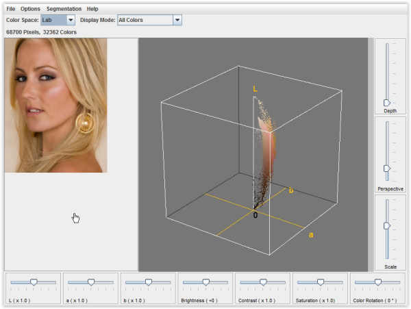

@martincregg - you are doing a visual assessment of the print outputs with your Canon printers, and you are quite happy with the outcome and the similarity of those. Your findings indicate that the color rendition of the PC inks are apperently pretty close to the genuine Canon inks which makes your life easy as long as you don't switch papers.
I did this - I looked up the icc-profiles PC is supplying for their inks on the RedRiver papers which they recommend very much , the gamut volumes - the total color range of printable colors do not vary very much between the Pro 10 and Pro 100, and their black levels are very close as well which creates the impression of overall contrast.

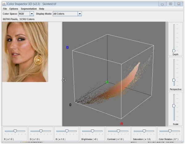

You are addressing skin colors , I did a little review of those and display a photo of a fashion model in a rather unusual mode - every image pixel has a RGB color, and all image pixels are placed into the RGB color space
The skin tones stretch along a diagonal line from RGB=0 at the left to RGB=255 at the top right corner,
so skin tones are not very much saturated. You can view the same data in the L*ab color space, the neutral axis (gray) stretches from the bottom to the top vertically , you get this view with the
same image

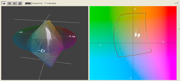

I'm switching to a different gamut viewer (for reasons of convenience and display options) and
overlay this pixel cloud with the PrecisionColor profiles for their UIltraProSatin for the Pro10 and Pro100 and their inks for the Pro 10/100 resp.
The left part shows the pixel cloud of the portrait with the transparent gamut bodies, the right image
shows a cut of that 3D image at a lighter color - L*=70 - you see that the white pixels are rather far away from the gamut borders and both gamuts are pretty close together, all such skin tones can easily and correctly be printed with either the Pro 10 or Pro 100 - there are no 'out of gamut' colors.
And if you think that one printer tones the skin reds slightly different than the other printer you should be able to correct that with some color adjustments in the driver.
If you would start using other inks or other papers or both in combination the color rendition issue could become more complex and may require you to use custom icc-profiles - or heavier adjustments in the driver - but that's a different subject.
(The green line applies to the Pro 10 gamut, the red line to the Pro 100 gamut)

That's the same pixels of skin tones located in the color space as in the image above, I just changed their color to white for better visibility.
