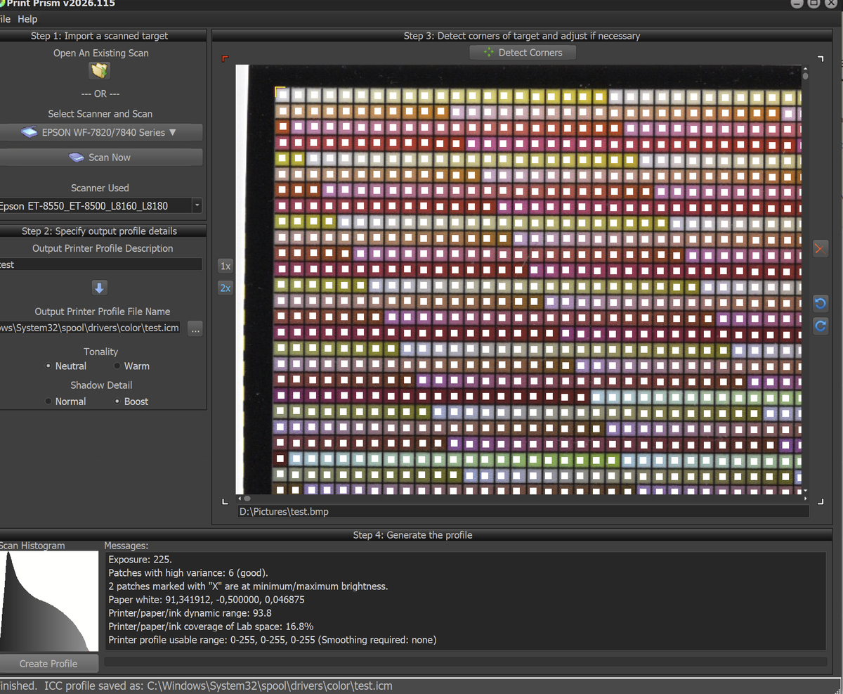

That is strange: I tried to use my Epson WF-7840 scanner if it would give a good profile (officially not supported) and to my astonishment the profiles are almost the same:
I tried the WF-7840 printer as scanner and using the ET-8550 scanning engine in PrintPrism:

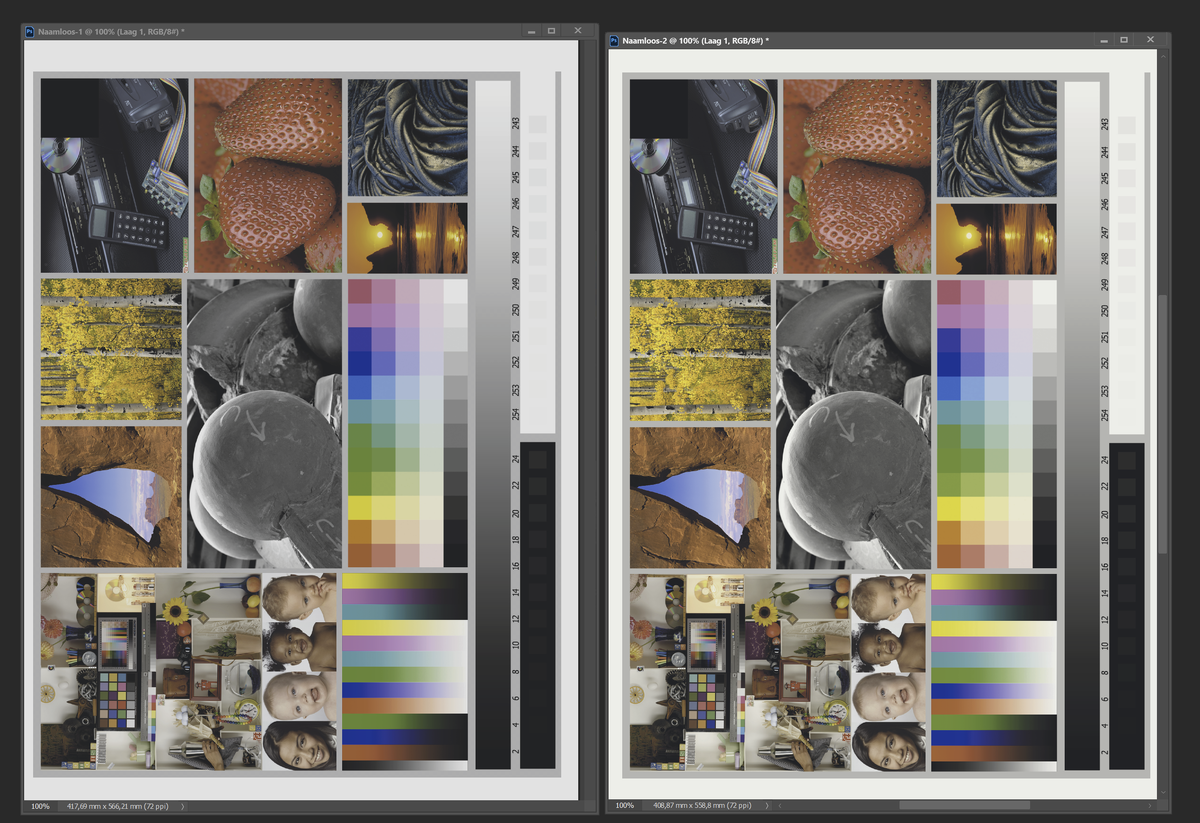

Beneath softproofing with a PrintPrism generated profile: left with my Epson WF-7840 (not supported) and right with the supported ET-8550....They look similar to me.....

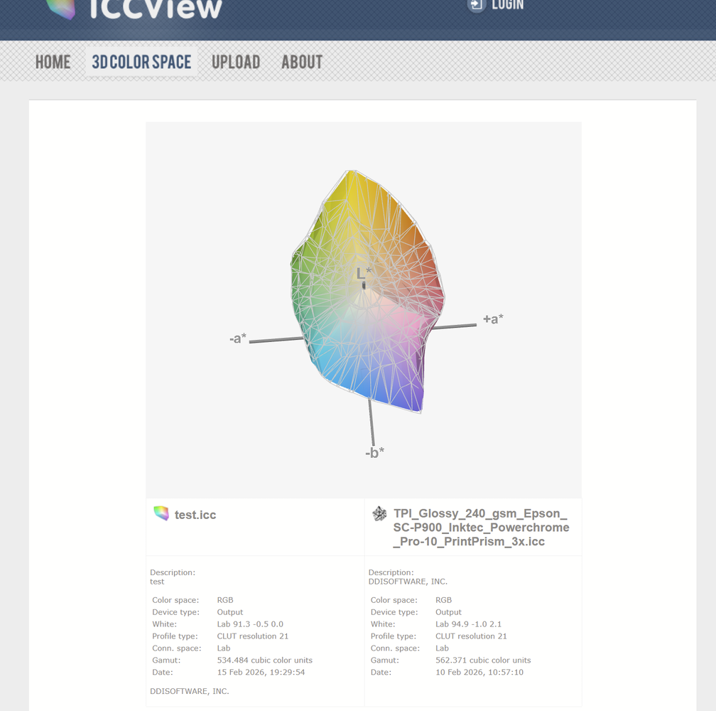

Now the 3D plot on iccview.de:
test.icc is the profile made with the officially not-supported WF-7840 scanner:
This is very surprising to me....Could it be the WF-7840 is using the same scanning hardware als the officially supported ET-8550 ???

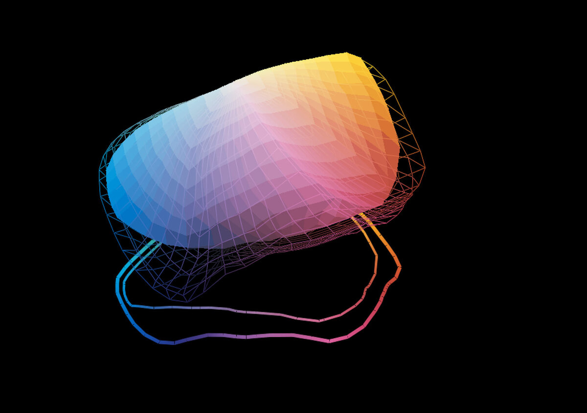

Later, I just made a print profile from a 3rd party dye ink (BCH) loaded into one Epson 3880, and the normal pigment ink in the other 3880 made using Print Prism. The dye ink was larger color gamut in the wireframe than the pigment ink, which I sort of expected as shown below.
