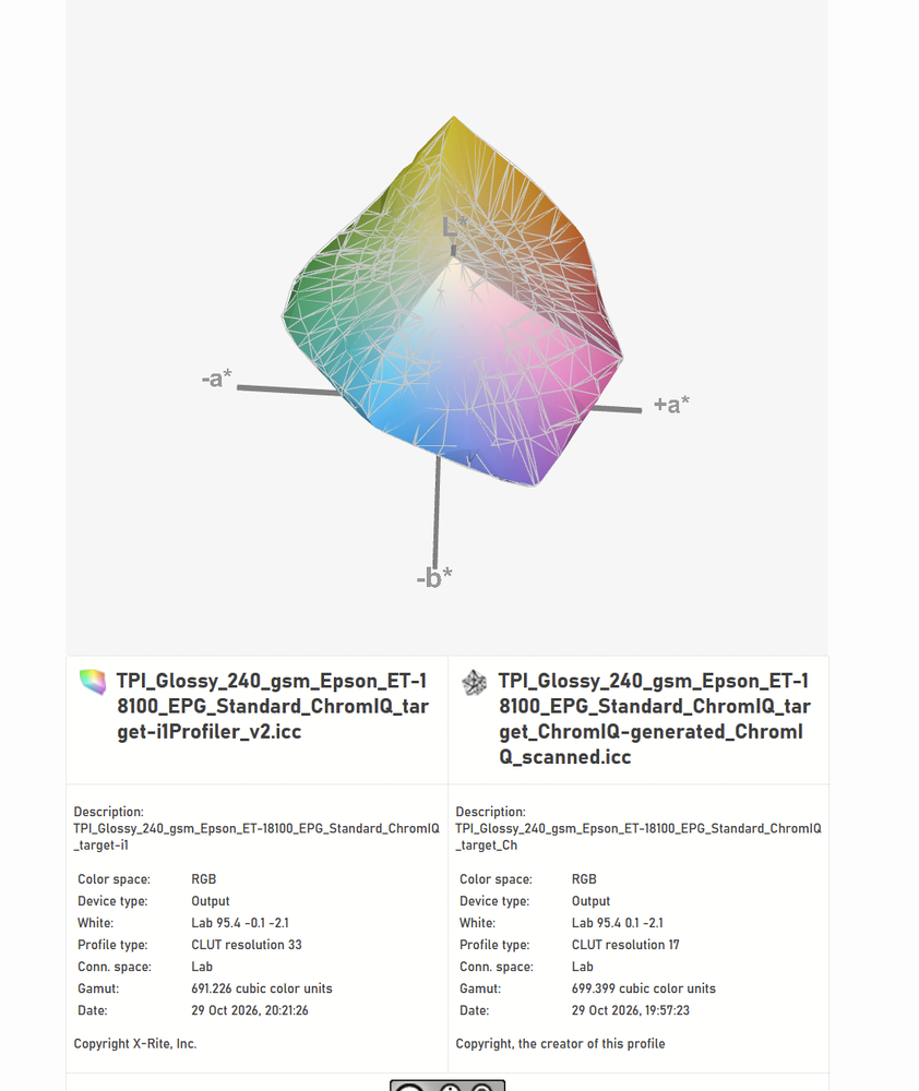

This time the white point of both profiles are exactly the same. A slight difference in gamut volume (most probably by slight scanning deviations within the margin of error)

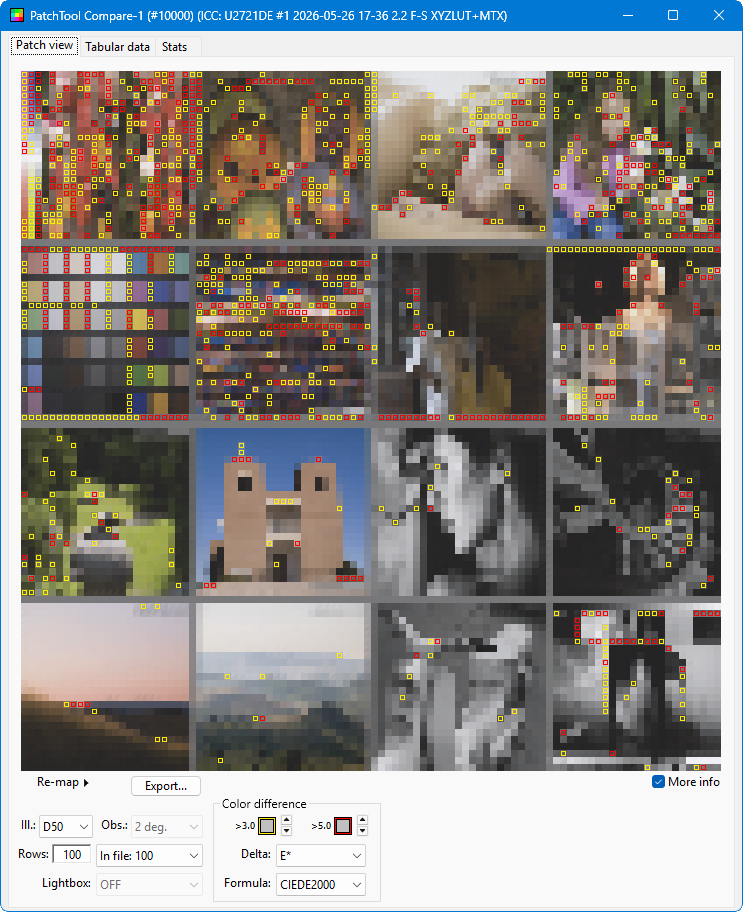

Digitization Resolution 100x100 and with wider pixel sampling
