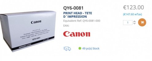

If I want to disassemble the printer and try replacing a new head (it's still a lot cheaper than buying a new printer and then it might at least with some care and attention last some good few years more) how do I go about it.? The sides are already off. I am not worried about using a screwdriver and some gentle persuasion, but I am sure there's a good way and bad way of doing it.
I live in the EU and the heads don't seem to be that easy to find. I came across a French site but I am wondering if they are genuine heads. I'll try phoning Canon support to see if it's possible to buy from them, but so far they haven't been at all helpful. I have heard the warnings about buying via Ebay.
Maybe it's a gamble but worth a try?
If you wish to proceed with the replacement of the print head, the first thing you need is to purchase the head and if you’re worried about dodgy sites selling heads then post the link to the website here and we can determine if they are genuine or not.
Don’t not proceed with any more dis-assembly till you have received the new head and please stay away from all Canon support sites because they’re as useless as a tit on a bull and don’t know a thing about the Pro 1 printer.
The top cover removal is fairly easy and only takes about 5 minutes but you do need access to all sides of the printer(360), so it needs to be in a clear space, the instructions with photos we’ll give you, but first purchase the new head, the box should have a hologram on its lid..
