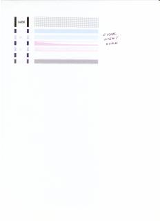

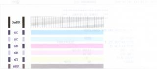

I'm sorry I didn't get the message across. Let me try again. There was no print out from the dye inks. I then followed your advice by placing a drop of Windex on the small mesh on the print head. I saw some improvement and repeated the process because it continued to improve. after the 6th time the nozzle check pattern actually was worse than the previous time. I tried the Windex process one more time with the resulting printout being worse than the previous one. I felt as though this procedure had stop helping and moved on to your next suggestion.

At some point, could you upload a copy of your nozzle check? It will be helpful in determining how much hope there is to get your printer working again. Use the Upload link at the top of this page.

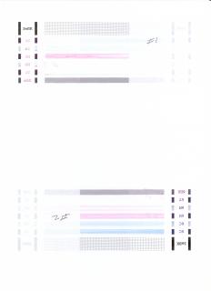

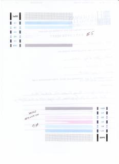

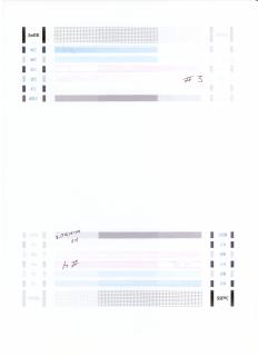

Here is the series of nozzle check printouts while putting Windex on the screens and the purge pad. I ran a couple with out doing the Windex during the process and those are noted on the images.

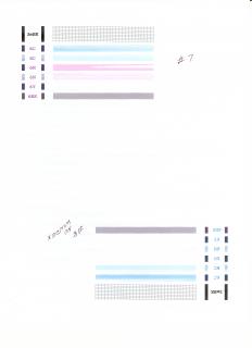

The following image is of the nozzle checks I ran after treating the pads on the cartridges with Windex.
The image posts aren't that great. Let me know if you would like me to post the full size.

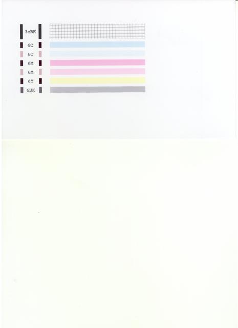

I only need to see the last nozzle check that you have done in full size and preferably on glossy photo paper.

Here is the final nozzle check. It's looking pretty good.

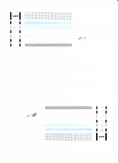

Yes, the normal nozzle check looks pretty good but to be absolutely sure, you should do an extended nozzle check by following these instructions. This will let you see the output from each individual nozzle.

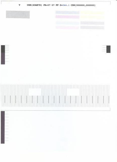

Here is the extended nozzle check.
