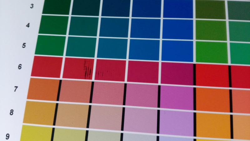

OK, I've run some tests now. I've been using Rives Tradition 300g paper for all my tests.
Reducing the Intensity by 10 or even 20 still made the paper wave. Same with Brightness set to "Light". BUT when I compare the darker patches on the calibration sheet, then those printed with Canvas as the media type, are nice a deep, but the paper did not wave. Yet the ones with reduced intensity or brightness do wave. Both to the point that the print head rubbed against the paper and the sheet became useless.
This made me think the problem is not the amount of ink. It seams it may have to do with how the printer handles the media when it's set to Canvas. Feeding the media to the printer is different. Is it maybe that the 30 mm margin is necessary for the printer - maybe the printer holds on to the edges and stretches the canvas slightly and this is preventing the paper from waving?

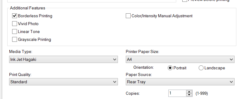

Ink Jet Hagaki with standard quality did not make the paper wave. So this is probably the way to go.

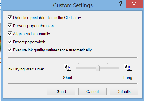

Go to printer Maintenance and select Custom settings and use “Prevent Paper Abrasion” that will take care of the head hitting your paper surface..
The 30 mm margin setting is only related to the Media type and not the paper surface you’re actually printing on, and the amount of ink is also related to Media setting also..

Thanks. Did not know this. I looked for something like "set the hight of the print head" in the settings. :)

Hmm, it looks like the problem is not with the paper. The print head rubs against the paper now even with Fomei InkJet paper... What could be causing this?
