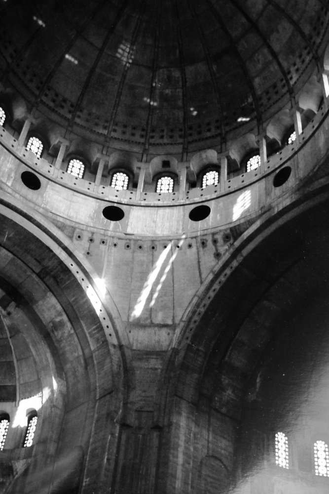

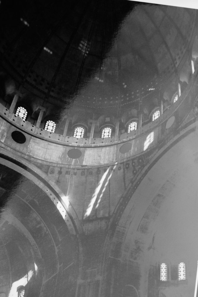

Yes it is a dye ink printer. I'm not sure how to call this effect. Is this bronzing? To illustrate it I am posting two shots of the same b/w print. The first image shows the normal appearance of the print (the light source is not reflected on the surface of the print). The second image is taken from an angle where the light source is reflected on the surface of the print (in this case it is the sky) and here the effect becomes visible.
It is like this regardless of the paper or profiles I use. Only black ink is affected. The greys are fine.
At an even more extreme angle (not pictured here) the black areas appear thicker and more uniformly spread. This effect reminds a little bit of a laptop screen seen at an extreme angle.
View attachment 2156View attachment 2157
I'm afraid I can't offer any explanation for the effect that you are seeing. However, just for the record, here is an example of what I understand to be bronzing. This compares two different pigment inks on the same paper - one clearly much better than the other.
