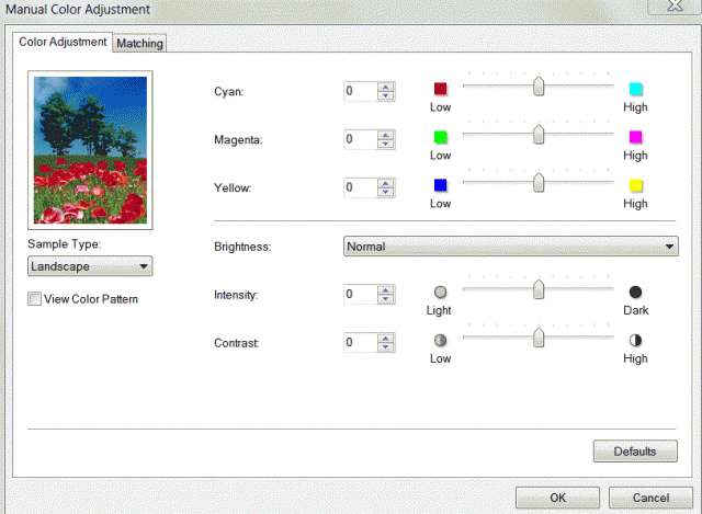

Either use the Manual Colour Adjustment in the print driver or profile your inks to solve your colour cast problem, simple..
View attachment 2216 click to enlarge...
I did use the manual settings and the green cast was gone but the prints looked the same as described above. Anyway I should not have to make any changes since the profile and paper are the same. This is a manifestation of a deeper problem.
