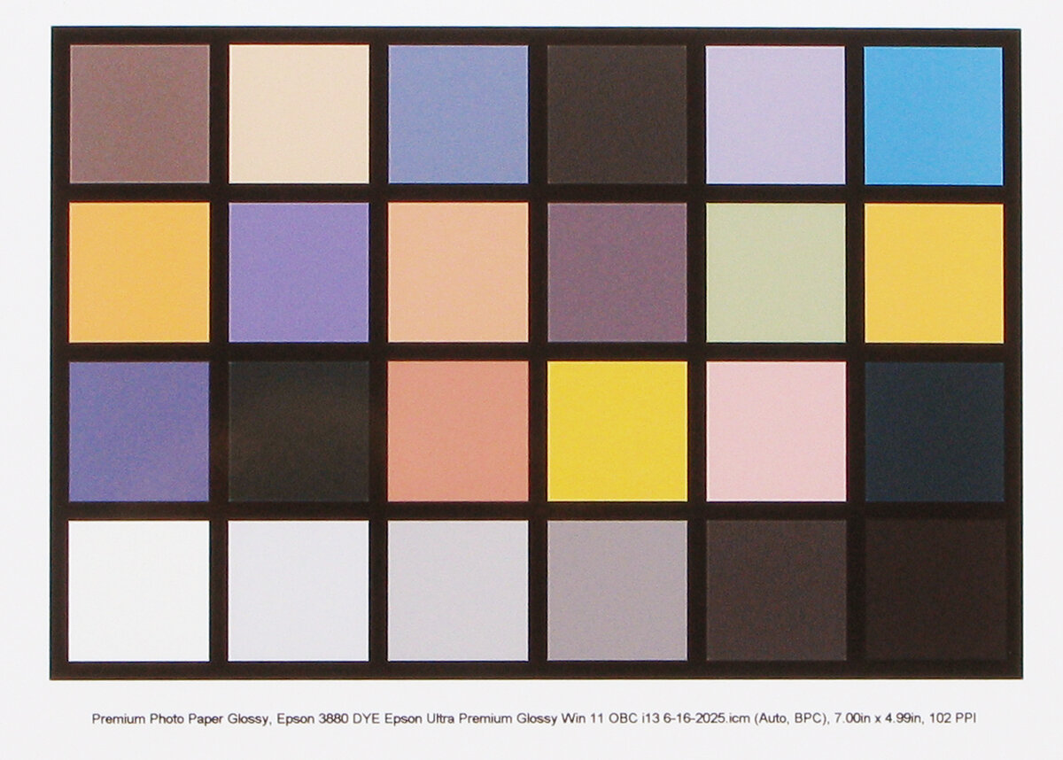

Below is the results of the ICM profile from the newest i1Profiler 3.8.5 with their i1 PhotoPro 3 spectrometer using WIndows 11. Also, I used the OBC portion that ccStudio doesn't have to eliminate any OBC out of the paper. Still, it's Yucky! Improvement in the blues, but now the reds are faded. They fixed one thing, and broke another.

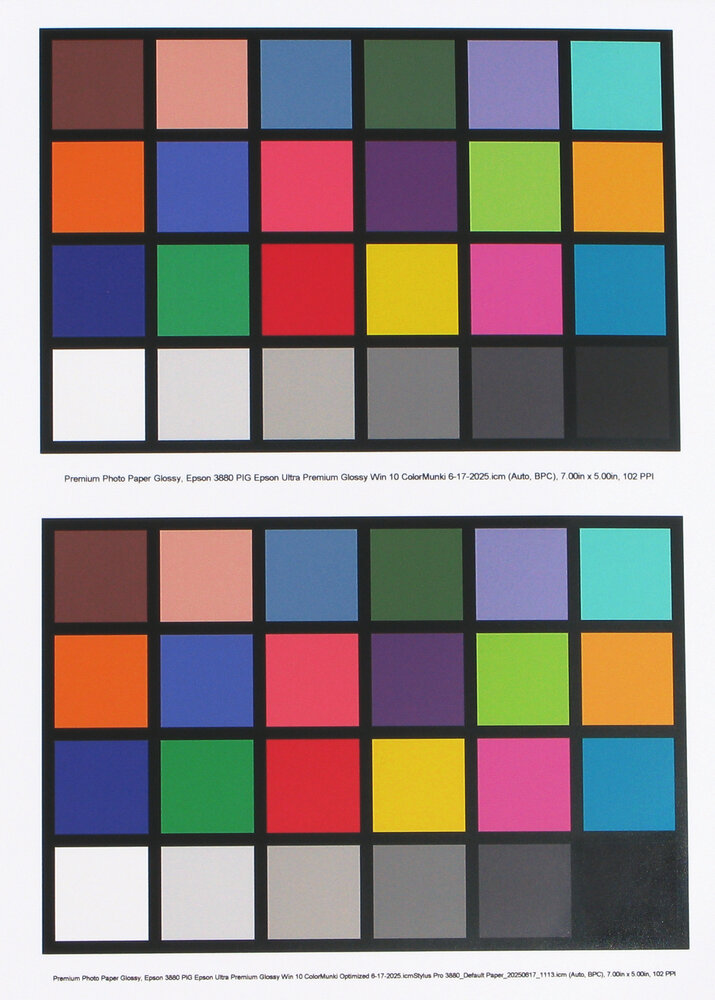

Below is a new Windows 10 profile made this AM after disaster with Windows 11 again. An Optimized and Non-Optimized profile via the ColorMunki and ccStudio. I'm now out of paper and not wanting to dig into box four just yet at $50/box. Least Windows 10 is tried and true.
