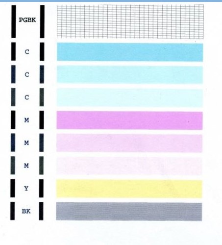

For starters that’s not a nozzle check, and you shouldn’t be printing anything other than a nozzle check till you can get all the nozzle at 100%
This is a nozzle check, so stop doing any other print tests.. !
View attachment 12083 click to enlarge..
So my nozzle check is so bad, it doesn't even look like a nozzle check. My nozzle check I think only shows PC, R and PM when compared to the nozzle check from a Pro-10s.
