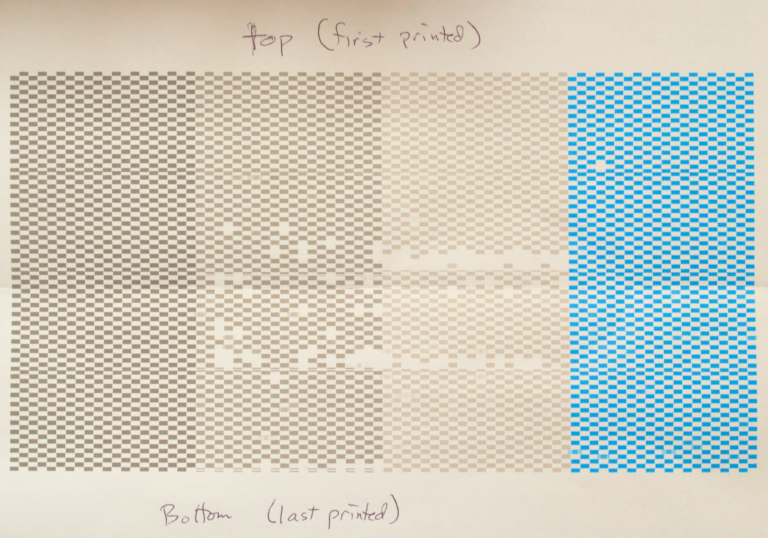

I tried running "Auto" nozzle checks, and it only made it through the first part (black and Cyan). The first pattern only had one bad (cyan) block, so it did a cleaning cycle and tried again, but subsequent ones got worse. Then it quit with "Cleaning Error, Press the Cancel/Reset Button" and never even tried the Y/M/LC/LM set.
