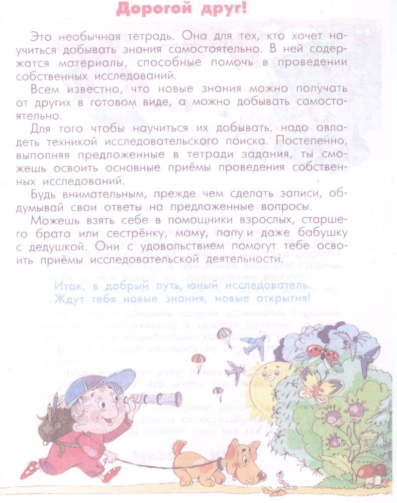

I've a second-hand PIXMA iP4200 with a new print head. Never used it for colour printing, and never really cared for nozzle clogging (though the cartridges weren't completely dry, I believe). But lately I wanted to print something in colour, so I bought some compatible InkTec ink, opened up the original (somewhat dry) cartridges, refilled them, done some built-in nozzle cleaning - and got this:
Note the cyan banding. Also note that even the text itself is not properly black.
This was a printout of a PDF file via Adobe Reader under ye ol' WinXP done on a plain paper, though the latter is hardly a factor, as you'll see below.

Anyway, this would have been the end of it, 'burned' print head and all, had I not tried to print the same page borderless. And what I got was this:
Note the total absence of any banding whatsoever. The fact that the colours (even the ones previously unaffected) are paler are, I presume, down to Canon's driver trying to prevent leakage when forced to print borderless on plain paper. I then tried increasing colour intensity in printer settings and got 100% normal colours, even the blues and the greens.

I am afraid a horizontal line on the cyan nozzle check is an electric failure in your head and precursor of the "blink 5 times error = change print head".

Pattern in nozzle check print is correctly described by @palombian
One thing - not every time it means further damages to printhead.
There is one solution, that allow to mask this banding at cost of half intensity in color printing. Only necessary tool is electrical tape and snap off knife.

I can only guess, that borderless printing is uni-directional in contrast to default bi-directional printing.
Service Manual is claiming, that borderless printing (especially on plain paper) is bi-di mode, but in SM dedicated to next gen printers (eg. iP3600) it is stated, that borderless printing on plain paper is uni-directional.
Printhead in iP4200 is nearly modern Pixma printhead.
Dye nozzles are organized to allow full bi-directional printing - color nozzles are organized into ink channels: C-M-Y-M-C.
Each ink channel consist of two nozzles rows: odd and even.
And C and M have doubled nozzles number, because they have additional small droplets (small droplet is 1pl, standard dye droplet is 5pl).
So, first C (and M) ink channel has 5pl odd row and 1pl even row and second C (and M) ink channel has 1pl odd row and 5pl even row. Y and dye BK ink channels are solely 5pl droplets, each of them is just 5pl odd and 5pl even row side by side.
If bi-directional printhead is used to print in uni-directional mode, then only half of it nozzles works - only odd rows (or even rows - hard to tell without testing).
And electronic failure posted above is when exactly half of odd or half of even fails (it mean 1/4 of total nozzles for certain droplet size for certain ink color - for instance 1/4 of Cyan@5pl). So, if half of nozzles are disabled by uni-directional printing, then is 50% chance to not use those, which are already defective.
I think here is explanation.
