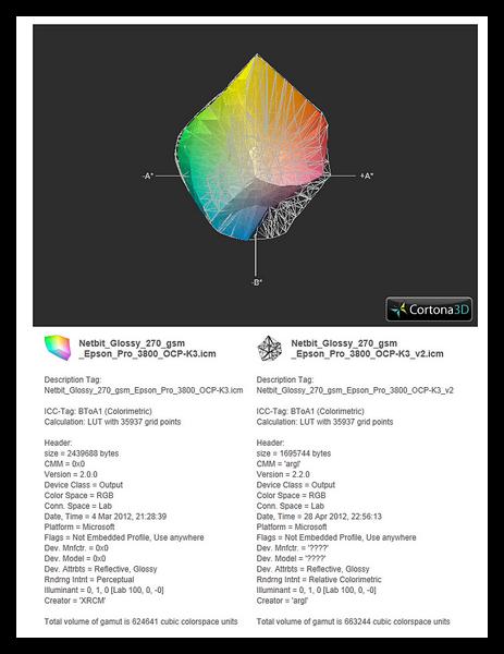

Hi Tin Ho,
I have done tests and the magenta is really not pure, but more a saturated orangy red, causing a dramatic drop in gamut in the blues/magenta/purples. All printer profiles I made for several papers have that strange indentation in the area between cyan and red (difficulty to reproduce saturated blues/purples). After having this weak magenta substituted by a another magenta (Octopus Office own brand T0343 magenta for the Epson R2100/R2200: a printer of the K2 generation, only lacking the LLB) the problem was gone. This ink is equally priced as the OCP magenta.
So I am now using a combination of OCP K3: PK, LB, LLB, C, LM, LC and Y and from Octopus Office Magenta.
Have a look at this picture:
Note the strange indentation in the purple/blue area of the solid figure (OCP K3 only) compared to the wired one (OCP K3 + Octopus Office Magenta).

Do you think I could replace the Magenta with Image Specialists M from Precision Colors of from Inkjetcarts.us since I am in the USA it would be a lot more convenient.
I can not test on the 3800s yet as I have a ton of ink left in them. But I can run a test on my R2400 whicih is runing on OEM carts. I will test on a set of refillables and run parallel test prints on both OEM and the OCP and then OCP + IS MAGENTA. Using my Colormunki Photo to create a few profiles.

Yes you can. For the Epson Pro 3800: to purge the magenta ink line you can print 7 sheets of A4/Letter with a solid rectangular with solid magenta (R:255, G: 0, B:255) without any color management, so the printer will put pure magenta on your paper. This way You do not have the clean the printhead 5 times to have the lines filled with the new ink, if you only want to swap out the magenta.
For a fresh setup with a new ink set you will need to execute a cleaning cycle 5x to completely purge the lines and have the printhead primed with the new ink.
Did you read my other post at this link:
http://www.nifty-stuff.com/forum/viewtopic.php?id=7643
Please take care to see of the purples and blues are vivid and really purple (and not a reddish brown and not muted, including the blues), because you have a Colormunki too and will be able to see it immediately after printing the first patch chart.
