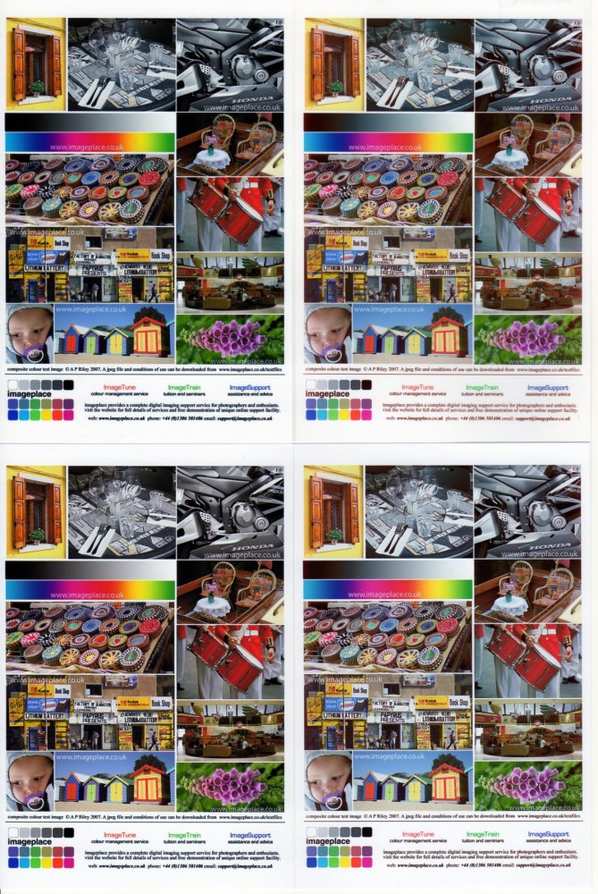

Epson 1500W / 1430
Scan 1: Epson Claria Photographic ink (OEM)

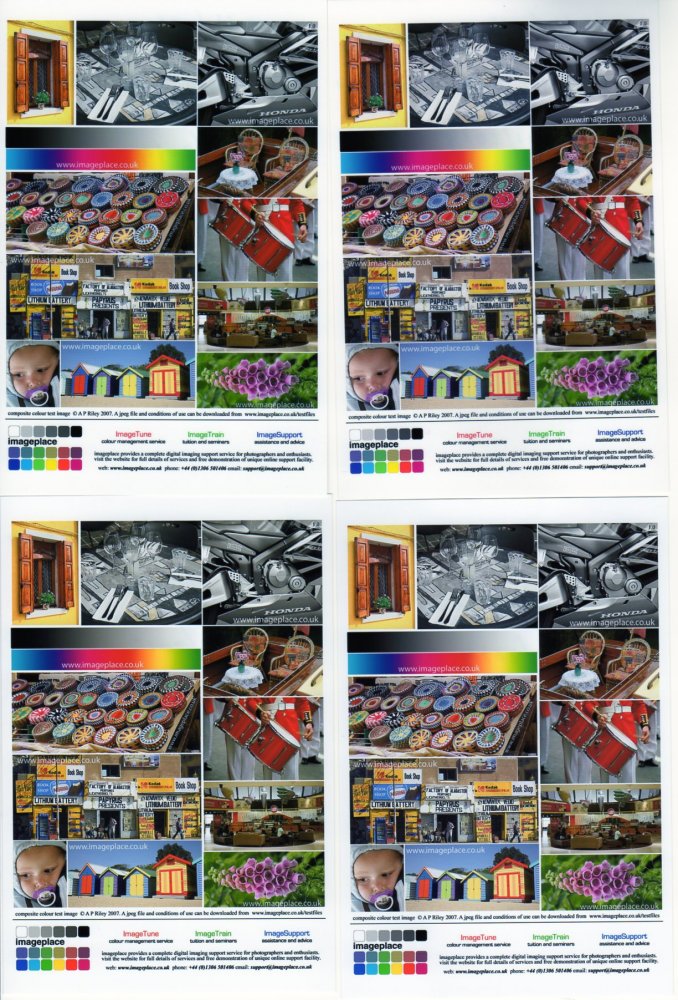

scan 5: Coralgraph dye ink
i testet it now because of your good results... and...i wanted to wait 6 month but after 2 weeks i geht this...
(coralgraph on the left)
