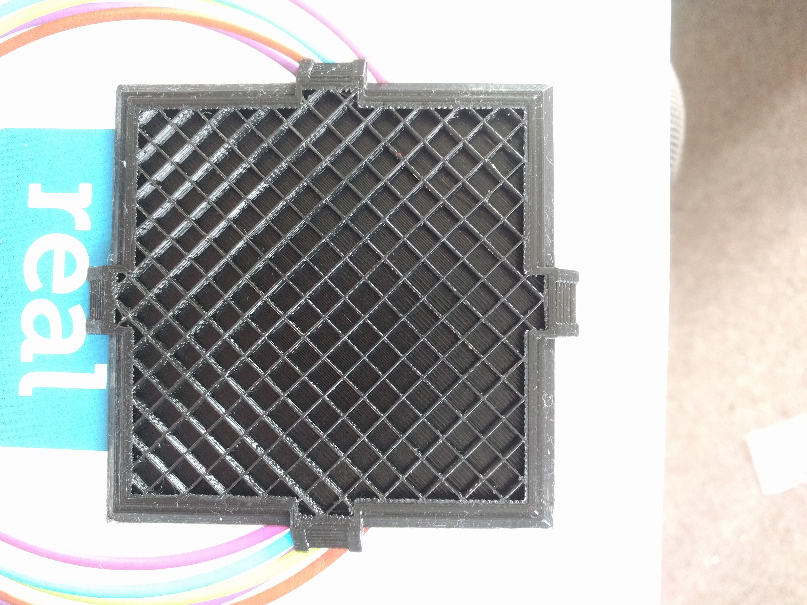

Well, I finally did my first print on my Anet A8. I just selected one of the files that came with the printer, a pyramid, which I thought would be a small simple polyhedron. Wrong! It became clear this pyramid was going to have many levels with steps up to each level. Also it was massive. After 2 hours it had only printed 16% and I wanted to go to bed. So I cancelled it. It's a very stunted pyramid.
Actually the photo doesn't do it justice. The real object looks a lot better; the bits on the sides are the steps to the first level.
My main problem was trying to remove the print next morning. I was using this tape. There's no possibility of reusing the tape after I finally managed to separate the print off it, and I've scratched the print bed as well. I'll try once more with this tape and if there are still problems try either glass or different tape.
I have a couple of MOSFETs on order to take the extruder and bed power off the mainboard. So I will print this mount for them next. I don't plan to print anything else till these power mods have been done. I don't want to risk over stressing the circuit traces that at present are carrying the high current on the main board.
