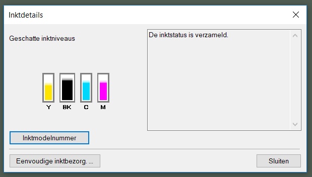

Status of mine after 400p incl about 200 double side = 500p text with graphs, photos on A4 (but also nozzle checks).
Filled with 80ml black and 40ml colour.
No idea for how much the ARC's are designed, but since regular volumes are lower (70 and 19ml) they should show empty before my carts.
With approximately 1/5 used the black seems to last about the Canon estimates of 2500p/70ml.
And with 1/3 of the colours, if the ARC's count down for 19ml the announced 1300-1500 pages per cartridge are attainable.
Seems too good to be true, but in any case, with ink at 15% of the OEM price, the paper costs more.
Even with original Canon ink this printer is cheap to run.
