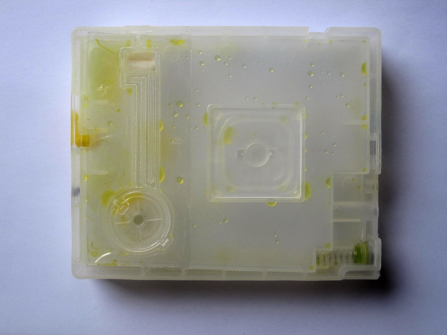

I assume the cart is not filled like the OEM's i.e.the syringe does not make a perfect seal in the port when filling and is not cycled up and down to expel air/ink.
Thanks for the info.
I received with my carts a small plastic tip to place on the syringe reducing the diameter to make it not fit thight in the ink fill hole.
So I injected ink that way letting air evacuate around the tip.
I removed carefully the sticker from the "old type" refillables.
They seem to contain some pressure equalising mechanism also.
Behind the square in the middle is a (very) small airbag that collapses when pressing on the cartridge.

Very interesting to see this. I think the bags are just for pressure equalisation in these carts rather than to hold ink.
The bag on the side is to accommodate expansion due to barometric pressure and temperature fluctuations. When the cart is initially filled the accordion looseness of the bag will end up exerting a positive pressure on the nozzles. Until the bag has been pulled back to the inside, you could encounter dripping. I think about 1-2 cc of ink consumption will pull the bag back into the cart and THEN the negative pressure will begin developing. So if you refill and then do not use up 1-2 cc of ink, then you will likely have drips.
One way to get around this is to actually fill the cart completely and then draw out 2cc of ink and then the bag will collapse inside and thereafter the cart will hold negative pressure. If you do not get the bag to collapsse you run the risk of drips.
It appears you all have just refilled and printed a little bit but not sufficient to collapse the bag and generate the pressure and thus end up with drips.
I'm also thinking at this point that if the pigment ink has insufficient surface tension, then drips could occur as well even with the pressure set up. Has anybody checked this aspect?
mikling
Jul 2, 2006
3,239
1,472
Toronto, Canada
Remove the square cover and see what the bag is. It is a loose bag that flops around. Why? That circular thing on the left is likely a flapper valve that allows air in but stops flow going the opposite direction. It will have some hysteresis on the flap so it will take some level of negative pressure to open the flap. The opposite flow direction will be perfect. Now, what happens when the cart is half full or nearly empty and the temperature rises? What happens to the air inside the cart.
Expansion of the air and ink....if this expansion is not accomodated somehow, what happens.
The ink is forced out of the printhead because the flapper valve will seal the entrance. Hence the bag.
Now what happens when the barometric pressure fluctuates? Hmmm. similar situation as above.
Now you will begin understanding what the cart is trying to do and how it works.
All of these valves etc. require some degree of proper assembly. and that is where the problem is sometimes.
In summary, there is always one entrance point and one exit point and something must take care of the dynamic environment.
