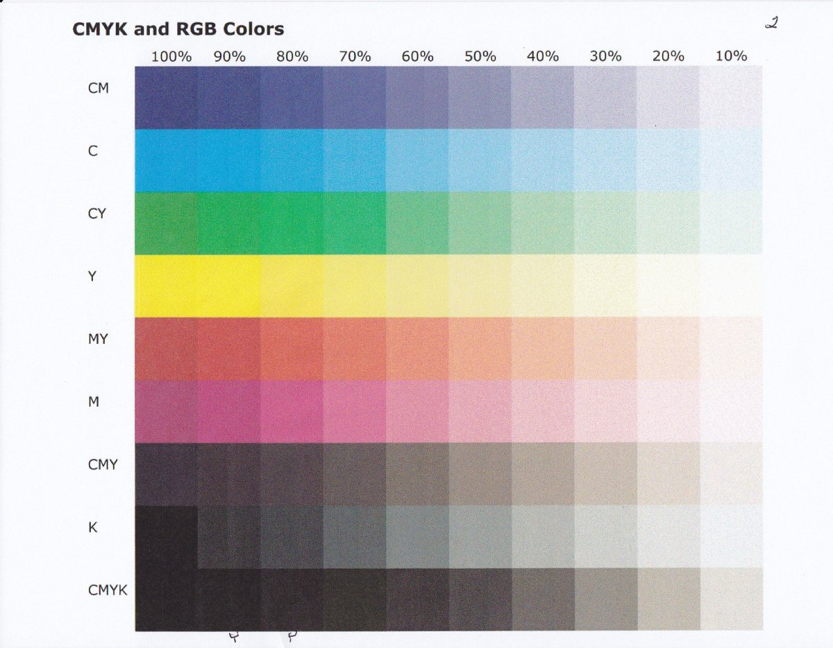

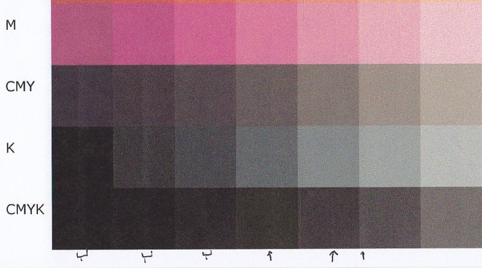

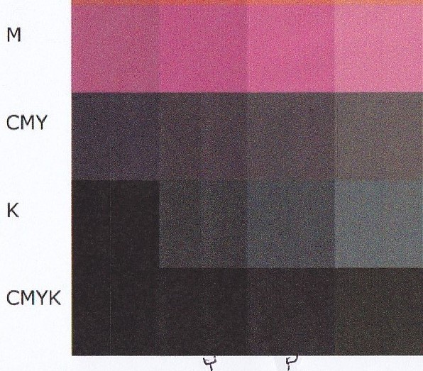

First, the printer knows you have opened the paper cassette, even though no paper was added, with the power OFF (but plugged into Mains). Spooky.
Second, I just tried @The Hat 's image for a stress test. The first printed page seems perfect. Starting with the second print out there are noticeable artifacts in the last three colors CMY, K and CMYK, which happen to be the Browns and Blacks. Recall, my first notice of a defect in printing was with a ~80% Brown, if using The Hat's graphic as guide. These defects increased over the next 8 pages of the 10 total printouts in the Browns and Blacks only.
All the other colors/blocks appear to be as in The Hat's image.
First image is the second page printed. Defects noted.
The second image is a crop of the problem areas, marked with brackets, that begin on the second page printed out.
The third image is a crop from the ninth page - the worst of all the pages. (Ignore the right-most arrow.)
Interestingly, the vertical defect between the first and second arrows was not very noticeable when I marked the page but is now since scanning. The scanner was better than my eye.
I then called Canon Tech Support. See next post.

See and determine if the vertical marks are actually indents left by the exit rollers. I suspect that it is. The small fold will show up more in scanning because of reflective light.
All carts operate by either negative or positive pressure. How it achieves that pressure will depend on the design. Some are active and some are passive.
I did the same test.
On normal settings C and BK have defects, on high quality everything OK.
Since it was printed in landscape the indents of the rollers are sideways (from dark to light).
80g Double A paper.
Very understandable when the paper is soaking wet with ink.
In real printing this seldom happens and the indents are not visible.
Maybe so but I do not detect any indents, folds, or creases in the paper. Will see with new printer if same issue occurs. If so then could be a design flaw in the Maxify or my choice of plain paper: Boise Polaris, Premium Multipurpose Paper, 24 lb., 97 Bright, ColorLok, 8.5'x11".
Please describe what the indents look like and where they are located specifically. Can you capture the indents themselves with a scanner?

What I see on standard setting on gradient prints is that there are vertical bands due to either imprecise feeding of the paper or due to not perfect printhead alignment. ( Ised the automatic alignment)
Must be what the Canon Tech Support guy was thinking as well since he had me do an auto head alignment. His conclusion was it is a hardware failure and that is why he is sending a replacement printer. Maybe it is a design deficiency.
Maybe the printer is unable to smoothly shift from one color to another because of this
Wouldn't you then expect the defect to occur when the color changes?
The defects appear about midway in the block of color. These defects seem consistent in position but are variable in height, not just in relationship to other defects but also variable in height individually. The defects are also seemingly equidistant apart, supporting a hardware issue. Then there is the rare vertical defect of a few microns width loss of ink, as if the paper or print head skipped a beat forward.
