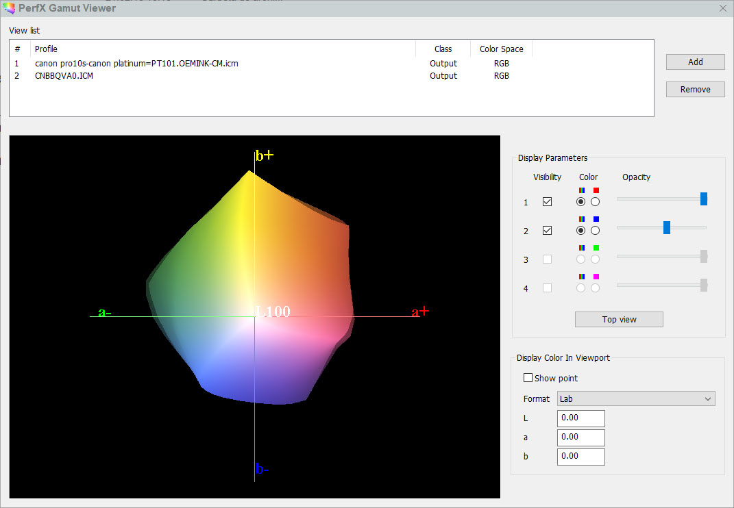

Take with a grain of salt the custom profiles made with the Color Munki Photo, This device is OK. for getting pleasant results to the human eye of real life colors but it isn’t accurate enough for a precise evaluation of gamuts in the highly saturated areas of the spectrum. This is true specially for glossy papers, which are usually coated with plenty of OBAs to increase the perceived ‘whiteness’.
I think that we can compare with reasonable precision the profiles made with the same instrument and printer for different combos of papers/inks, but not the profiles made with the ColorMunki vs the ones obtained with the expensive sophisticated spectrophotometers used by the manufacturers.
Below there’s a comparison of gamuts from two profiles. The first is my custom Color Munki profile for Canon Platinum using OEM ink from the starter cartridges of my Pro10s. The second profile (greyed ) it’s the one provided by Canon for the same printer, paper and, of course, OEM ink. You see that there’re visible differences, albeit small, in some areas. The Canon profile shows more extension on the orange-red zone, magenta and green-cyan. Yellow and purple-blue are practically the same.
In theory, dealing with the same printer, paper and inks both profiles should be identical. In real terms, there’re other variables interfering - different hardware, rendering intents, etc..

@palombian - Netbit was an alternate source for the Aldi Glossy paper - I have profiled both papers with various inks on several printers, the gamuts are a close match . Netbit is not a manufacturer like Sihl but a distributor , the actual origin of the Netbit papers is unknown to me - I assume some Eastern country - I got some time ago ink and papers from a Polish distributor - Falter - which did Cone inks for Europe, and the gamut of their paper was very close to the Aldi/Netbit material.
@Artur5 - your and the Canon profile are a very close match, I would not think that such small differences would be visible at all on actual prints. I have seen much wider differences with Epson - Epson inks on Epson paper - my and their profiles compared.

@Artur5 , you are pretty close with the Colormunki indeed.
Such differences - if real and not a measurement deviation - are invisible in a print.
