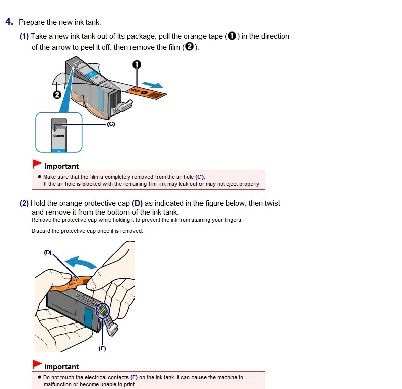

bluecrabby wrote:
Vent sealing tape? Well, I unwrapped it as specified for installation into the printer...
If you followed Canon's instructions it should be OK. See this picture from a Canon onscreen manual, and note the little figure "C". This is how the cartridge should look after removing the vent sealing tape. click to enlarge:
I now see in your first post that you refill your cartridges. So what method and inks do you use? If you are using the classic topfill method, it is extremely important that the cartridge is sealed properly after refill, else the cartridge will leak. If ink entered the vent system during refill, it might block the vent and cause ink starvation.
...I discovered that there seemed to be a vacuum issue, and if I pulled out the filler plug to allow air into the reservoir area, that the ink would flow into the sponge and feed the printer again...
This makes me think that the vent was blocked by ink.
I would not buy a new printhead if leaking caused it to fail, but if there was no leak, I would buy one, if a reasonably priced printhead could be found.
