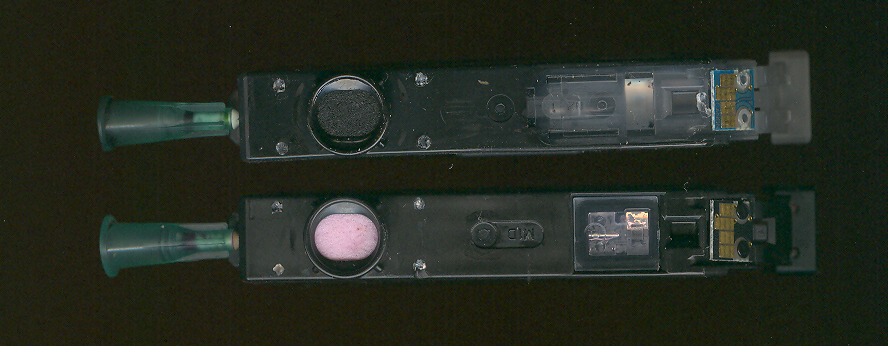

magenta coloured sponge in grey 226 cartridge, how queer!

So just spent some time processing my used set of oem 226 cartridges, flushed out the gray cartridge and the sponge appears to be magenta stained...
Flushed with distilled water, is this accidental chromatography? gray isn't a primary so it has to be made up from a couple of colours eh?
The distilled water seemed to work very nicely and efficiently as it only took just under two litres to flush the whole set of six cartridges clean.

That is typical of Canon grey. It has magenta constituents in it and these are very aggressive.
