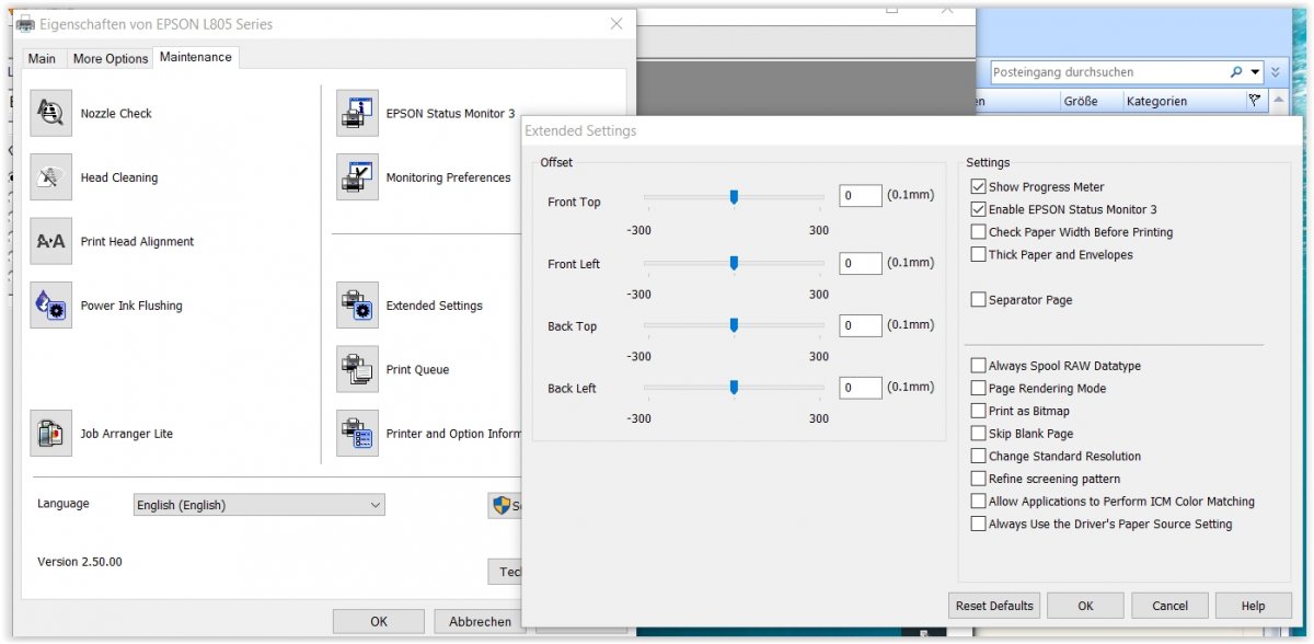

I'm getting the 'Refine screening pattern' option as well with the L805 driver, the tank system version of the P50.
- The printhead, nozzle plate would touch the paper if the platen gap is too small
- Color adjustments - that's a work around - experimental - try it - it's usefulness depends on the printer driver
- Maintenance prints are one thing - do you see a difference in a small actual image print with bidirectional printing - high speed - on or off ?

Correct, and I am not concerned about minute differences between printing modes when there are major (hopefully ink-related) issues. The scans from the PF adjustment menu are basically single-pass prints, so that's as unidirectional as one can go. I did just do a short test and both uni and bidirectional printing in Photo RPM mode show similar magenta stripes.
I guess new inks are the next thing to test...and this might take a while :)

It turned out to be an issue related to ink viscosity. Adding 10% glycerol to the magenta ink solved the problem completely :) When the printer is in standby, the head is parked right next to the wireless module which gets relatively warm. The increase in temperature must have pushed the ink viscosity just below what the printhead can tolerate.
