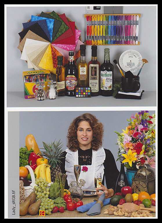

OK some pictures of the prints on TPI Satin 240 gsm paper (Conrad). This paper is very similar to Moab Satin and Epson semigloss paper.
The pictures are compressed to a much smaller size, but I think the differences should be clear.
Picture 1: Epson Pro 3800 with Inkrepublic IRK-4 nano pigment ink:
According to iccview.de the profile of the IRK4-nano has 691045 cubic colorspace units

So there is a significant difference in gamut between the IRK4-nano and the OCP K3. Both are printed with Qimage with exactly the same settings (using perceptual intent, BPC), 360 dpi output. Now maybe somebody can explain me this strange discrepancy between significant lower gamut, but more vibrant prints ?
edit: I see the nifty-stuff.com compression system seems to change the colour significant and does not reflects the true more vivid prints made with the OCP K3 ink. Those interested can PM me to have the original files sent to them.

On my screen the more vibrant OCP colours makes the IRK4-nano look quite dull.
