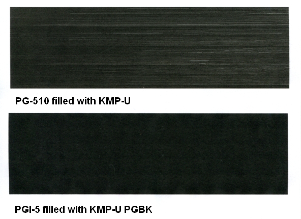

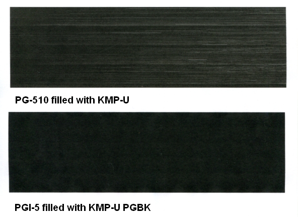

So do I. I have had similar problems with the black combi cartridges, both Canon and HP. A pigment black refill ink that works perfectly in a single ink tank cartridges like PGI-5, PGI-x2, PGI-x25 and PGI-x50 seems not to work well in the combined sponge/printhead black cartridges. Refill inks for the dye ink cartridges CLI-8, CLI-x21 and CLI-x26 work well in the tri-colour combi cartridges.
A dye BK refill ink can be used in the black combi cartridges. It is not perfect, but has fewer flow problems.
Here is an example of the same KMP-U pigment black used in a combined sponge/printhead cartridge and a single ink tank cartridge:
Please report your results with the other inks. Other people refilling the combined cartridges might have the same problems.
