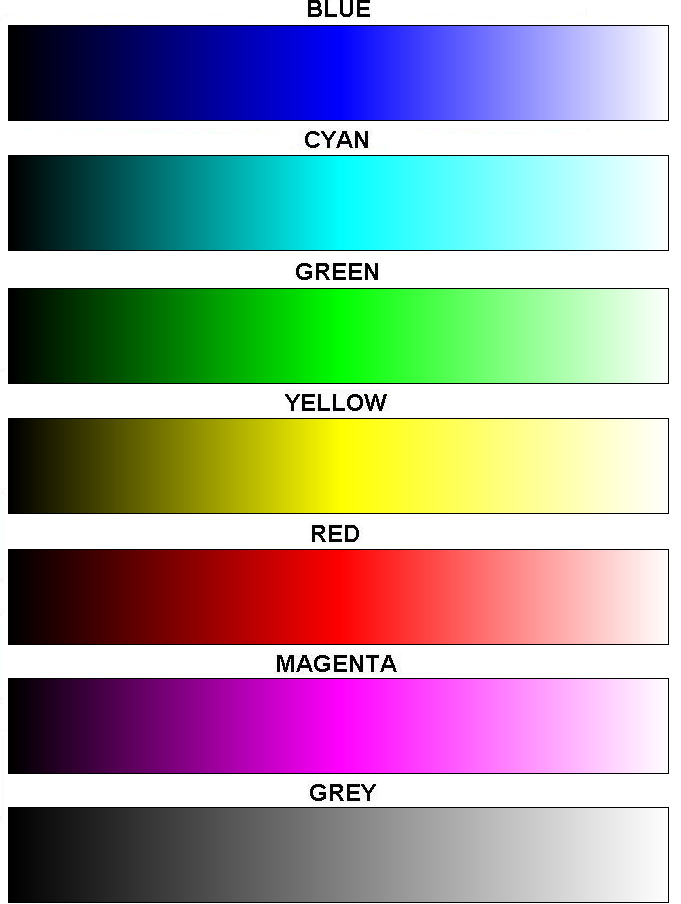

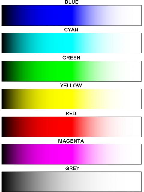

Actually after running nozzle checks it looks pretty normal to me but when I try to print a picture it starts printing normally until halfway through the print and then the color goes screwy.
I would think that if the nozzle check is ok , that would indicate that the nozzles of the print-head aren't clogged, and cleaning isn't the issue to resolve. Could be electrical or ink flow?
What happens if you really slow the printer down, and only do several light colored 4x6" prints? High quality will be slower, and my printer has a setting for drying time between prints. I would think that would put a lighter demand on ink flow. Maybe try ghwellsjr's test gradient, but lighten by a stop or two to reduce the amount of ink used.
