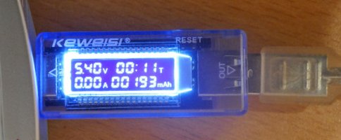

Be aware that the combo I1iO/i1Pro is sensitive to the voltage of the USB-port under load - it may work with 4.9 Volt but not with 4.8 Volt anymore, different USB ports on your computer may deliver different values. I have an old i1Pro which only works with an USB voltage above 5.1 Volt. It is the small halogene lamp inside, you get some deposit inside the glass bulb over time, but these little bulbs are not available anymore.
XRite tells you not to run the i1Pro via a USB hub, it works for me - with an external power supply, but these support the 5 Volt condition differently - the above one with 5.40 V, and another power supply only with 4.9 V.
