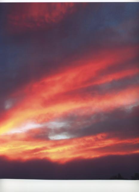

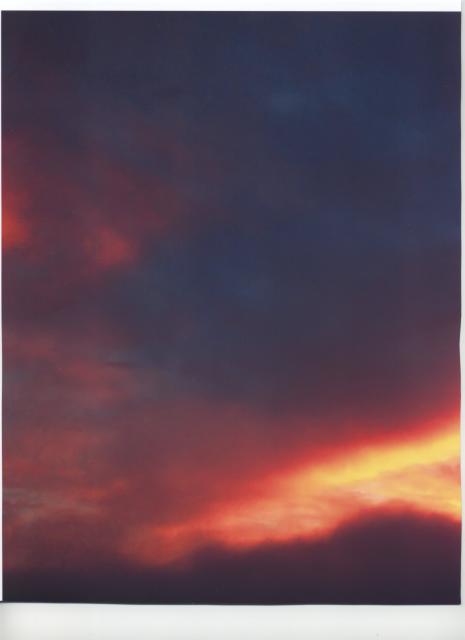

PeterBJ wrote:
It could be a problem with the paper feed. Apart from the timing strip the printer also has an optical encoding disc that determines the rotation of the paper feed rollers. I think that if this disc is dirty it could cause the paper feed systen to feed a few extra millimetres at some constant distance.
Could you please upload a scan of a printout showing the error?
I have scanned a couple of pieces of the large print and have uploaded to the forum but I can't work out how to attach them to this thread.
http://www.nifty-stuff.com/forum/uploads/476_epsn030.jpg
http://www.nifty-stuff.com/forum/uploads/476_epsn031.jpg
I've included shortcuts to them.
5,140
5,024
Your images are here:
I see nothing wrong with the printer, but jpg compression might mask the errors. For best results crop the image to show only the essential, and don't use too high a resolution when scanning. This is because only 80 kB is allowed per uploaded image, due to server capacity limitations.
A problem with a stained timing disk would have shown as inserted white (unprinted) lines across the whole width of the paper. I see no such errors. If the print head is not perfectly aligned/adjusted, it can show as fine banding repeated at some interval. In stead of doing an automatic alignment, you should do a manual alignment, using good light and a magnifier to choose the best patterns. It might also be better to use your photo paper for the alignment instead of plain paper, as the thickness of the papers is different.
Is the direction of print head movement vertical in the images? It is hard to see, but are there faint vertical stripes in the images?
If the images don't show the errors, you could try to crop an image hard showing only a small area with the error. This will allow a higher scanning resolution.
You are not the only person having had problems with uploading images, maybe this thread will be helpful?: http://www.nifty-stuff.com/forum/viewtopic.php?id=8281&p=1
