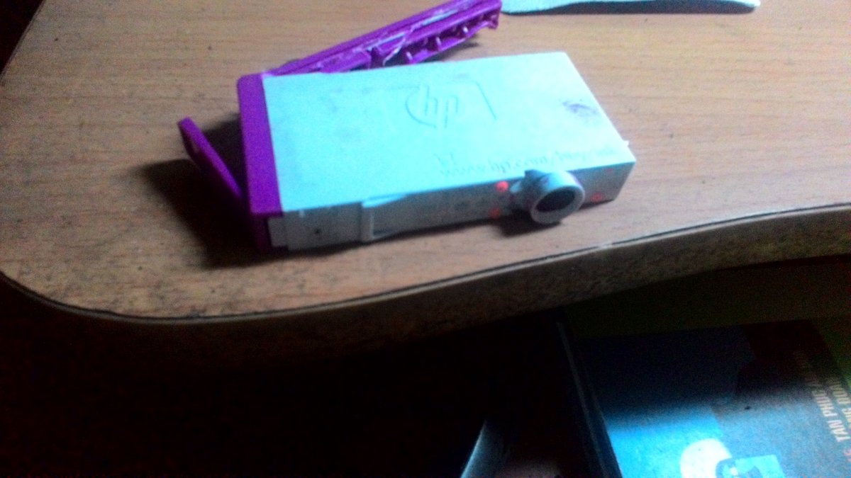

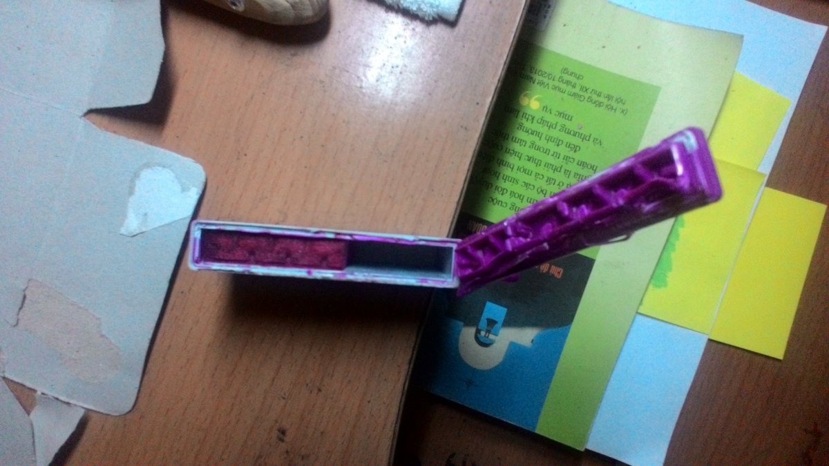

A few days ago, I found a used HP 685 Magenta in a trash bin near my house, so I picked it up. I decided to tear it apart to actually see what's in there. My assumption is that HP 685 is similar to HP 564 and some others.
However, this teardown revealed that HP685 is quite different!

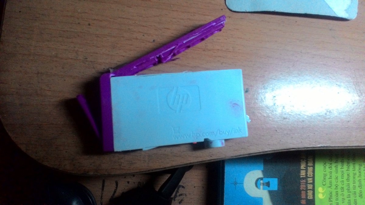

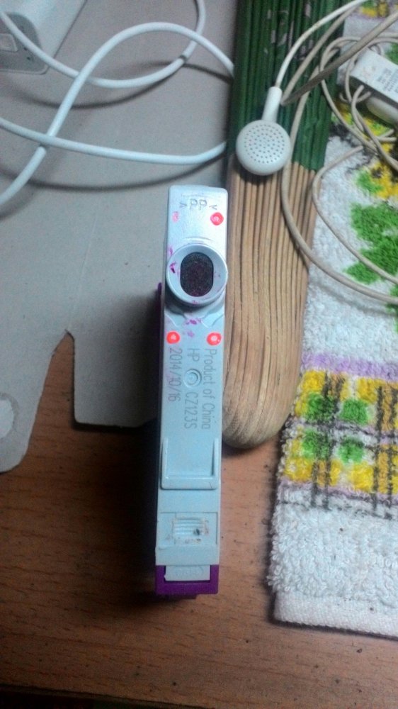

This is the HP 685 Magenta. It's very similar to HP564 Magenta, but there's no XL version of it.
Look very very similar to HP 564.

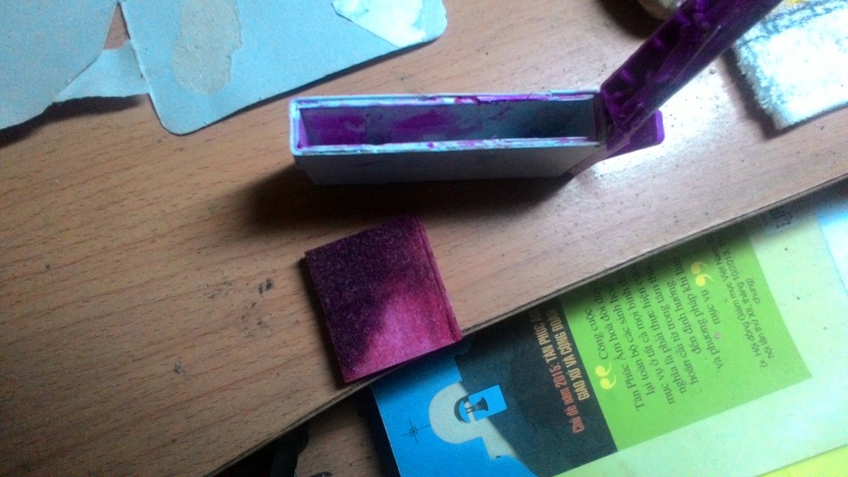

Open the top

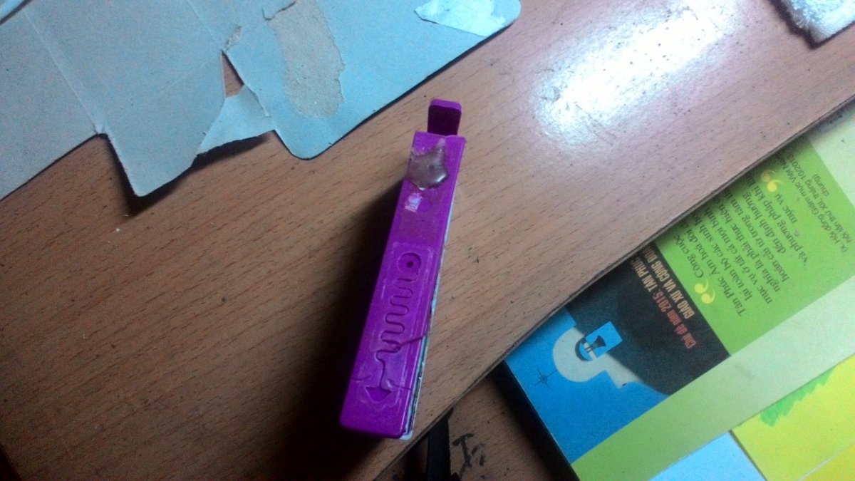

At the top, I tried drilling a hole where it supposes to go to the ink chamber, which on HP 564 is sealed and not linked to the sponge part.
I actually made a test by filling ink to the drilled hole, to see if they come out at the outlet port or not. And it surprised me that even after I filled and sealed the hole, ink continued to leak until empty.

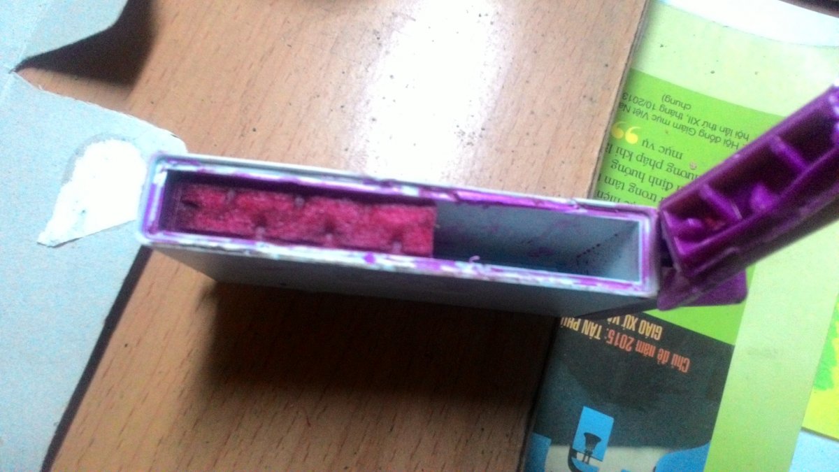

Surprised! There is no wall or ink chamber at all! Just one big space and a sponge. This explain the above leakage!
Close look.
And here is a second surprise: I thought the sponge would be in 2 pieces (not counting the outlet sponge), but HP 685 only has one single sponge.

Excellent photo series. :) The cheap (?) design also surprises me.
As these cartridges seem only to come in regular, not XL size, in stead of using the more complicated and expensive (?) design with separate ink and sponge compartments, a simpler design with only one compartment is used. If HP should decide to introduce an XL cartridge a larger sponge could be used with no other changes to the cartridge design.
For many years HP has reduced the sponge size to reduce cartridge capacity for the combined sponge/print head cartridges.
An example: This is the HP60 XL and this is the regular HP60. Notice the difference in sponge size.
