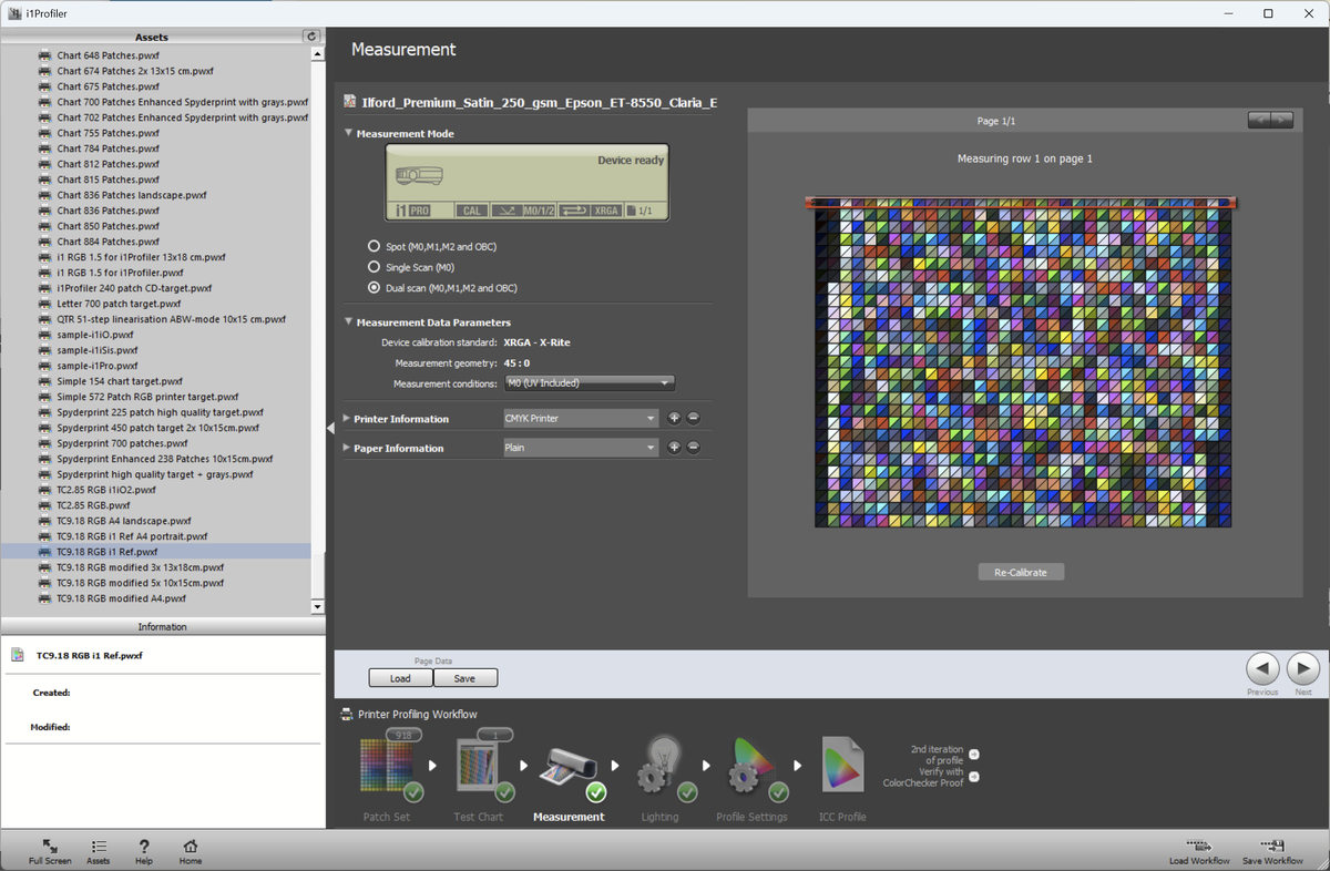

can i use the SpiderPrint target for the iProfiler that you built i seen in other post ?

Yes you can no problem at all. Here is a adapted version that is not to broad for your scanner/guider. It has 675 patches based on the Spyderprint High Quality target that is extended from the original RGB 5x5x5 to an improved RGB 7x7x7 and the Extended Greys target and some extra patches (near neutrals, generated by the i1profiler smart target generator) upt to 675 patches in total.

I just upgraded the previous patch set for i1Profiler, because I have experienced reading problems at a specific row with two patches so closely in hue that the i1Pro reads the two adjacent patches as 1 patch dropping an error that it reads only 24 of the 25 expected patches of the particular row. I have regenerated the target to use spacers in order to separate the adjacent patches. This should solve this problem. You can redownload the zip file again above or here:

If you still have problems because the jig/guider is too narrow (because your 3D printer cannot print the large version), try this patch set, because it is now elongated to 34 rows of 20 patches in a row (with 5 dummy patches to fill up the target up to 680 patches in total = 34x20). It takes longer to scan, but it should solve the problem of your current jig not able to reach from white begin patch (paper white) towards the other end and stops on a colored patch throwing an error that is only reads 24 of the 25 expected patches.
